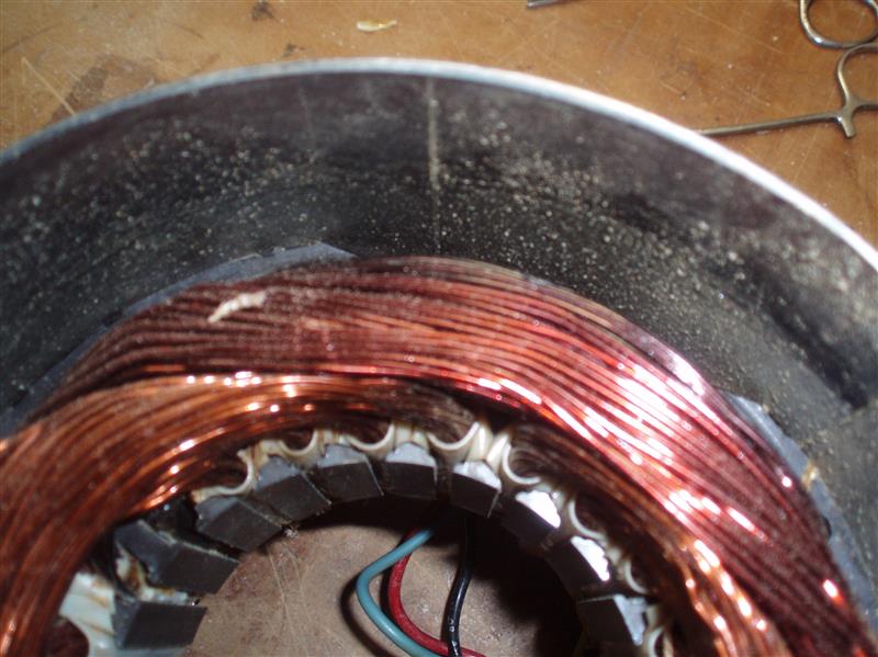

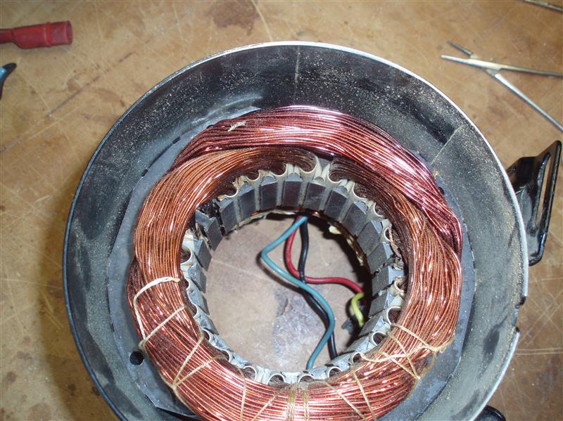

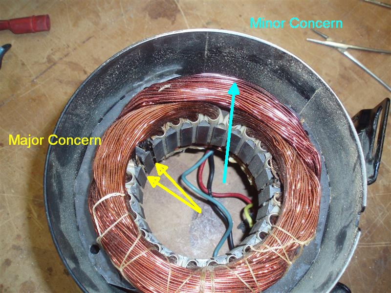

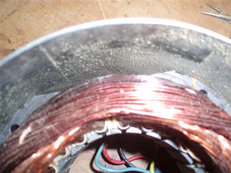

I've sorta taken that second look.
[ATTACH]22542[/ATTACH]
[ATTACH]22543[/ATTACH]
[ATTACH]22544[/ATTACH]
[ATTACH]22545[/ATTACH]
[ATTACH]22546[/ATTACH]
Looking close, you can see signs of heat. Some of the lacing is still missing. I retied the exterior leads back in place.
Now I am wondering.
Can I apply power to the individual windings without assembling the motor? If there are problems within the windings that caused the heat, would it be the same without the armature installed?
Now I am wondering.

dusty wrote:I've sorta taken that second look.
Now I am wondering.
IIWM, the next step would be Formvar(insulating varnish). Especially in the 'major concern' area. I would saturate those slots.
[ATTACH]22547[/ATTACH]
The where to buy 'link' had 10 local locations. I got my can on line per a post by Bill Mayo(Amazon???)
Whoops! Forgot this http://www.sprayon.com/products/clear_insulating_varnish
i.e. do not give up yet.
Future reliability could be an issue.
I would NOT apply 'power' while disassembled.
P.S. 'Fortunately' the charred area is the start winding.
- Overheated CS Motor 007 (Custom)2.jpg (285.86 KiB) Viewed 2310 times

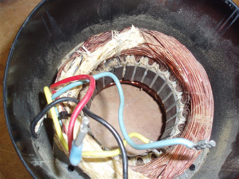

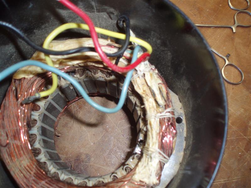

In a couple of the images I posted, you can see what appears to be masking tape in addition to the waxed string. Does that tape have any specific function.
In the areas that JPG highlighted as be of concern there appears to be what looks like straws around the wires - except in a few locations. Is this an insulating material? Is the absence of that material a problem or will the varnish fix that?

dusty wrote:In a couple of the images I posted, you can see what appears to be masking tape in addition to the waxed string. Does that tape have any specific function.
I do not see the tape in yer pix, but 'spagetti' or woven insulating tape is commonly used in the area of splices.
The slot insulators are there primarily to prevent scratching the enamel during winding. They also insulate the winding from the core. The burned away areas appear to be at the opening in the core. Varnish 'may' suffice there.
Your worst 'defect' is if two adjacent winding turns are shorted. Nigh impossible to detect by measuring resistance. Hopefully the varnish will prevent then from touching in the future. If the turns are shorted now, varnish will not 'separate' them and make the motor usable.
What happens is very high current flows in the shorted turn(only). It becomes a low 'resistance' secondary(like a transformer).
Unless you 'see' a short(very unlikely) do not move any winding wires.
