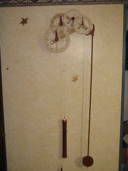

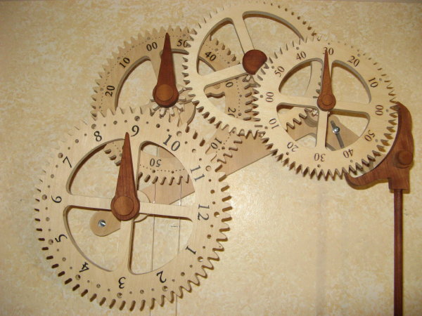

I added all the wheels and turned the unit by hand and everything worked fine. Then I added the pallet and pendulum, they have a very tight tolerance and the clock kept stopping. I played with it a little at a time sanding a tooth or one of the important faces on the pallet. Pretty soon everything was working.
[ATTACH]23587[/ATTACH]
[ATTACH]23588[/ATTACH]
The clock is losing about an hour a day and I don’t have the line on the weights set correctly yet. But I’m not going to make any changes for a couple weeks. I want to see if it breaks-in. If the clock loses time the pendulum shaft needs to be shortened.

Move the bob up about 3 inches.:)
