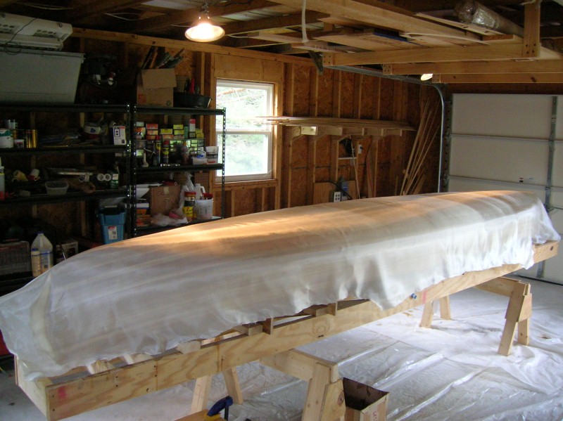

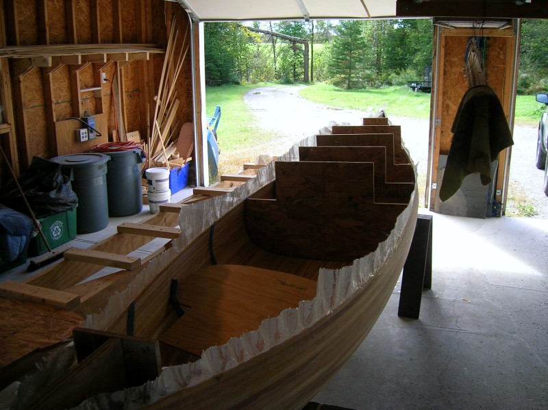

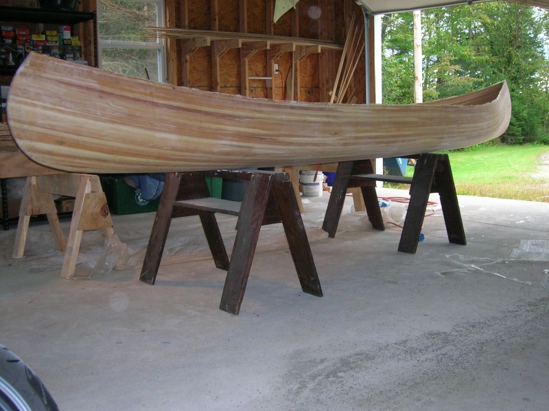

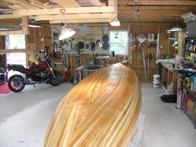

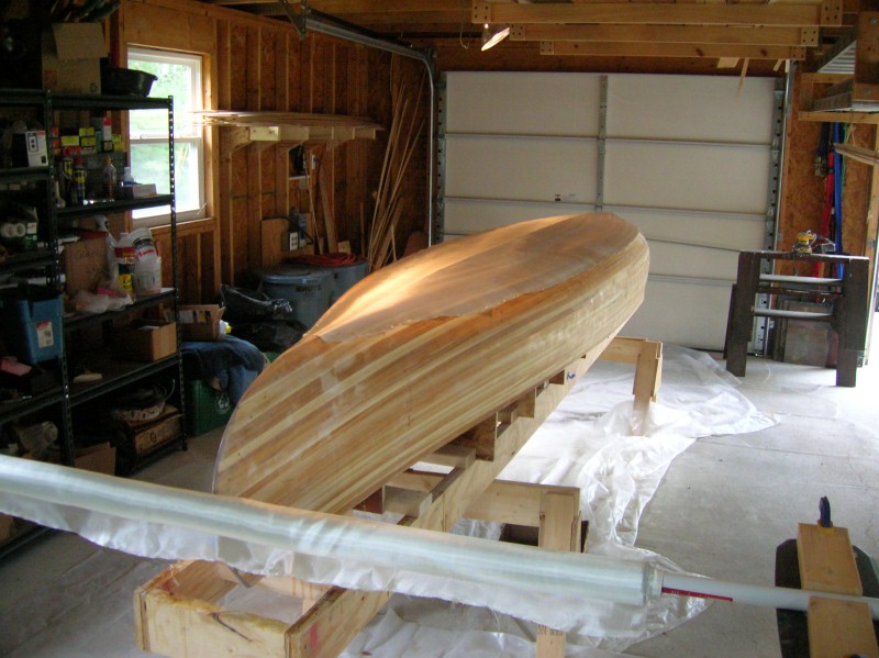

So thought I'd update progress. I've completed the exterior fiberglass lamination, and two filler coats. Also completed sanding through 60, 80, 100 and 120 grits on the fill coats (fortunately without sanding through the cloth). The fiberglass came out suprisingly ok, probably 6 spots less than the size of a pencil eraser where the resin was sucked out from behind the glass. I'm going to leave them, its a canoe, not furniture. I am suprised how easy fiberglass is to work with, pretty forgiving, can be frustrating but if you calm down and take your time it can be teased into about any contour. If it mess's up, sand it fair and start again.
I've flipped the hull over and stripped the forms, she actually looks like a boat now. Started scraping the interior, sanding will start tommorow.
Al, waiting to see some photos of that strongback.

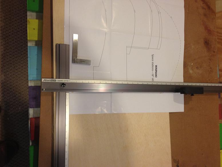

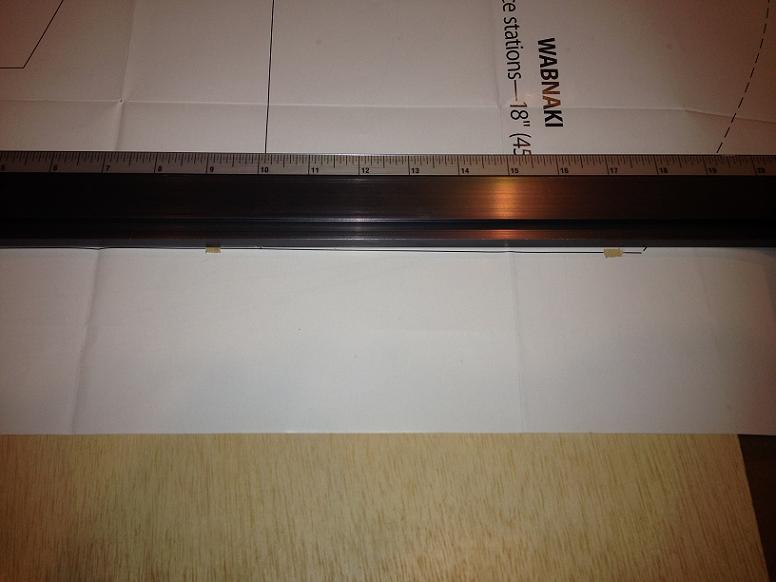

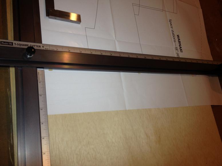

Newportcycle:
Ran into something odd on the Waknabi plans. Put a straight edge against the baseline of the forms/stems and discovered the baseline isn't straight. Somewhere around the intersection of the line representing the common upright for forms 2 through 8, the baseline begins deflecting and is about 1/4 inch away from straight by the time you reach the end of the stem form. I suspect this means the stem forms won't sit flush both with forms 1 (or 9) and the strongback at the same time. Did you encounter anything similar? I've emailed the author, Gil Gilpatrick to see if he was aware of the issue (he already let me know about an error in forms 1 & 9 and sent a corection).
Al
P.S. Tried to PM you but the forum says your email is no longer good.

algale wrote:Newportcycle:
Al
I dont remember anything being off and am having trouble visualizing what you are saying. When I set form 1 and 9, I set the bottom of the form flush with the cleat on the strongback, this left the stem down about 1" below the top of 1/9. When I was closing up the strips on the bottom I ended up having to really narrow up the stem to get the strips to lay right. Got a photo, that may help some. All this said, I may have made it work and been to stupid/stubborn to realize I was doing something wrong.

newportcycle wrote:I dont remember anything being off and am having trouble visualizing what you are saying. When I set form 1 and 9, I set the bottom of the form flush with the cleat on the strongback, this left the stem down about 1" below the top of 1/9. When I was closing up the strips on the bottom I ended up having to really narrow up the stem to get the strips to lay right. Got a photo, that may help some. All this said, I may have made it work and been to stupid/stubborn to realize I was doing something wrong.
Old email hijacked, had to start over should work now.
I've already heard back from author Gil Gilpatrick and he said it won't make a difference whether I choose to correct the line or not. A few photos attached show the issue (base line bending away from straight edge):
[ATTACH]23100[/ATTACH]
[ATTACH]23102[/ATTACH]
[ATTACH]23101[/ATTACH]

algale wrote:I've already heard back from author Gil Gilpatrick and he said it won't make a difference whether I choose to correct the line or not. A few photos attached show the issue (base line bending away from straight edge)
Well those photos point out exactly why I probably didnt have an issue, I was no where near that accurate. I bunched together some carbon paper on
luan, dropped the plans on and traced away, cut things on the band saw, taped them together and went for it, I did sand the forms to the line as a pair. My forms were probably off some here and there, but with the amount of fairing you do during the sanding phase I dont think it will show..
