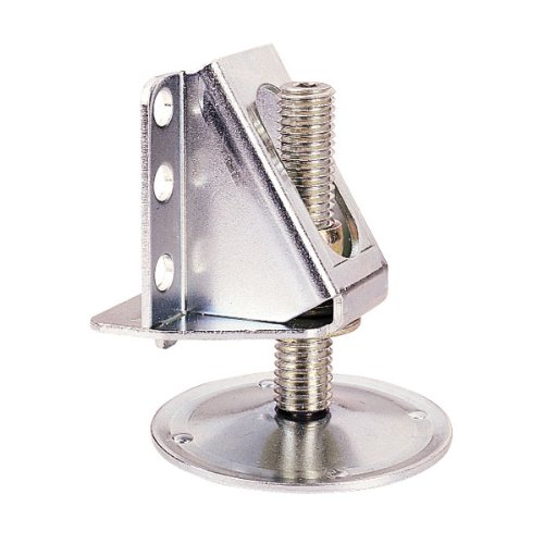

Heavy Duty Leg Leveler - Wide Foot
Post by rlkeeney »
This looks like it might work. I got the idea from Bill's post describing his heavy bench. If I mount the caster in just the right spot place I could run the levellers down to secure the bench when needed and up I think these have a allen socket so I could do it with a drill. They are relatively inexpensive ($7 each) and 440lb is certainly strong enough.
Amazon description: Perfect for cabinets, tables, or shelving units, these levelers feature a lipped mounting bracket that works to lift, support and create more stability. Wide foot leveler, 2-3/8" diameter, is sold individually. Made of heavy gauge, plated steel. Use a #5 hex wrench for adjustment. 440 lbs load capacity.
[ATTACH]22918[/ATTACH]
http://tinyurl.com/pb6juvu
Heavy Duty Leveler.jpg (29.47 KiB) Viewed 3839 times

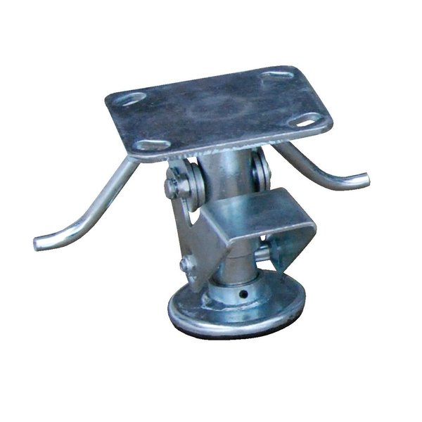

Floor Jacks
Post by rlkeeney »
I can get these for about $20 each. They look promising but I sure would like be able to put my hands on them and see how they work. There is a blog posting on Popular Woodworking about these.
[ATTACH]22919[/ATTACH]
There are a bunch of different ones. You can see some of them here.
They are not designed to lift. It's more like a brake. I might be able to get away with using two of these.

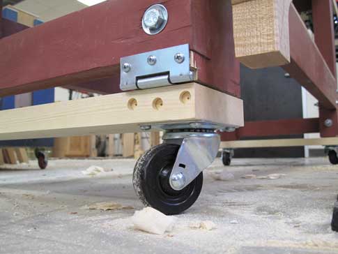

Easiest Way To Make Your Workbench Mobile
Post by rlkeeney »
I found the blog posting that goes with the video.
[ATTACH]22920[/ATTACH]
I saw some mention that these could flip if you hit something while rolling the bench around. In my shop this would most likley be an extension cord. I really need to do some wiring.

rlkeeney wrote:I found the blog posting that goes with the video.
I would think that could easily be prevented by adding a hook and eye to this set up. Although it might take more time to secure the hook than to move the extension cord or other obstruction.
If you have as much weight on them as you say I don't think they would flip unless you were going super fast and it would take more than a cord to do it. I have a welding table that has a 1 inch thick steel top on it and is 3 foot by 8 foot long and I have it on 5 inch casters. It will rol over so big thing and you don't even know you hit them
