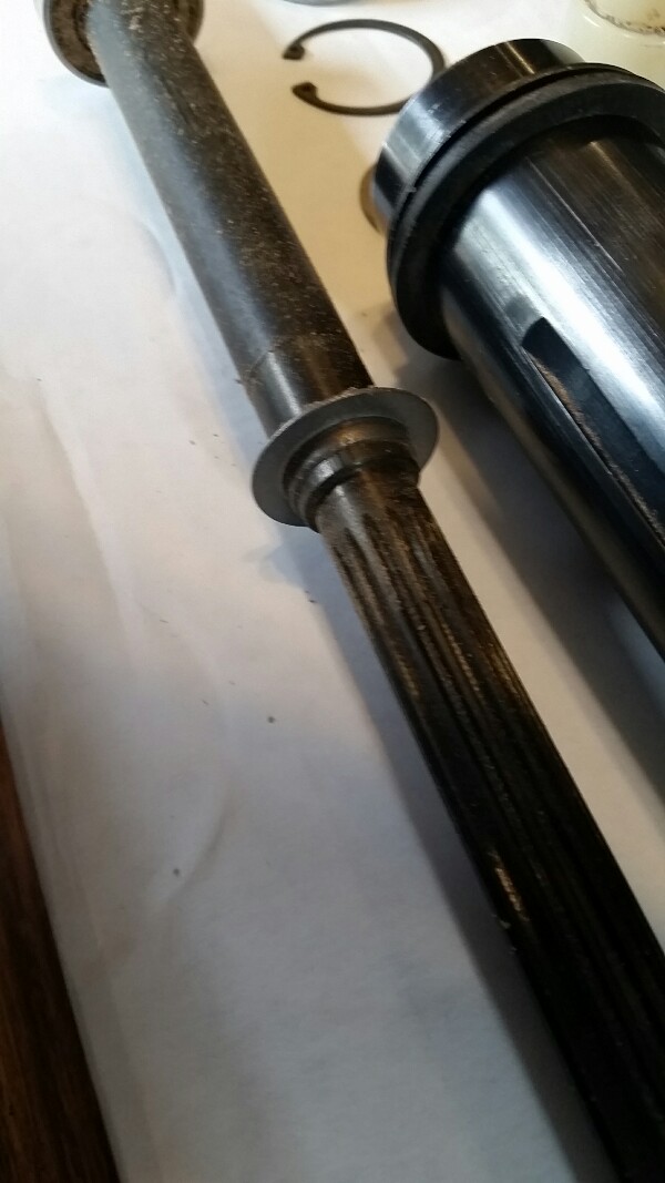

I've only replaced 1 single bearing quill, last summer I got one from Shopsmith. Mine had a dust shield. With the dust shield you can juuust see it doesn't contact the walls while with the new double bearing quill you can see the bearing in action when spun. Can I notice the difference? Seems to be fewer saw marks when ripping.

moggymatt wrote:I've only replaced 1 single bearing quill, last summer I got one from Shopsmith. Mine had a dust shield. With the dust shield you can juuust see it doesn't contact the walls while with the new double bearing quill you can see the bearing in action when spun. Can I notice the difference? Seems to be fewer saw marks when ripping.

Some engineer might call that a micro partial inhibitor, looks like a dust shield to me.

As far as we have ascertained the purpose of that washer is to make sure the shaft lines up the splines in to the nylon part of the drive when inserted.
Re: Double Bearing Quill?
reible wrote:As far as we have ascertained the purpose of that washer is to make sure the shaft lines up the splines in to the nylon part of the drive when inserted.
A far more accurate description of it's purpose!!!! :cool:

OK, maybe I should have said Nick's information in the video may be incomplete. I thought I was adding some valuable info for those who might be confused by the video, as I was. All I know is I was led astray when I relied on it. Since he said the probe would go all the way in on a single bearing quill, and the double bearing quill would stop the probe at 6", when mine stopped at a couple of inches in, I knew something was fishy. I also bought a "double bearing quill" from someone who performed the test and was deceived when they hit the dust guard on their single bearing quill. Shopsmith refers you to that video when you are trying to decide whether to buy a double bearing quill. They should update the information. In the meantime, take your quill apart if you are not sure.

sackbut88 wrote:OK, maybe I should have said Nick's information in the video may be incomplete. I thought I was adding some valuable info for those who might be confused by the video, as I was. All I know is I was led astray when I relied on it. Since he said the probe would go all the way in on a single bearing quill, and the double bearing quill would stop the probe at 6", when mine stopped at a couple of inches in, I knew something was fishy. I also bought a "double bearing quill" from someone who performed the test and was deceived when they hit the dust guard on their single bearing quill. Shopsmith refers you to that video when you are trying to decide whether to buy a double bearing quill. They should update the information. In the meantime, take your quill apart if you are not sure.
I have to agree that Nick's info is wrong.(at the least it is misleading)
A good look will remove all doubt. I have not seen many different 2 bearing quills, but the 'back' bearing is visible in those I have seen.
Now the single bearing quills had a spacer that helps align the splined shaft to the coupler during assembly. It may help shielding from dust, but that ain't it's purpose.
As always a clear LOOK is the best method(assuming one knows what to look for and can recognize it).
I do consider the poke method inconcise at best. Without looking, thee does not know what the poker is hitting.
