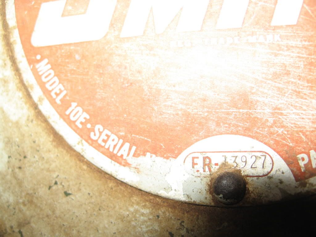

I can't find the information now, but I do recall reading that the letter stamped in front of the serial number indicated the factory it was built at. One of which was San Francisco. That the letter codes for the two factories were "E" and "R" does seem to cause some confusion!JPG40504 wrote:This is a lot of conjecture, but:
Initially the E stood for Experimental on those on that had 'Model 10' with no 'E' designation on the logo plate.
Later on the 'E' was added to the plate artwork.
Even later the ER was created, but logo plates were still available for use so 'R' was added to the stamped numbers.
Eventually 'ER" was added to the artwork on the logo plate.
Then the multi state production was initiated and the letters became state of origin indicators.
At least one machine carried a "C" letter of unknown reason.(R. J. Chr. . .?)
Truth be known, the veracity of the letters is questionable since they seemed to always use up old logo plate stock after a 'change'.
I don't recall ever hearing of or seeing logo plates that just said "Model 10" without the "E." To my knowledge, it was always the "Model 10E" and was later upgraded to the "Model 10ER." The letter code on the serial number was always to indicate the factory. With at least one exception.
The exception to the letter code indicating the factory of origin, is if the logo plate says it's a Model 10E, but "ER" is stamped before the serial number (as opposed to either "E" or "R" by itself). My first ER has this type of logo plate and serial number:
This indicates it was originally manufactured as a Model 10E, but was "factory refurbished" to become a Model 10ER before being sent out for sale.
Heath
Central Louisiana
Central Louisiana
Please accept my apology for previous conjecture!!!!
I like to 'verify' recollections, but obviously did not today!:o
I was confused regarding "E" on the logo plate. There are two places they 'appear'. 1)Next to the 'Model 10' small letters on the left periphery, and 2) to the left of the stamped SN.
I did not look at mine as it was not readily accessible. That oversight has been corrected.
[ATTACH]23040[/ATTACH]
As shown in Heathicus pix, the 'R' was added to the larger 'E' in the artwork independent of the stamping.
Anyone please make corrections to this as needed!!!:)

This is my recollection as well, with one deviation - both of my 10E's have plates identical to JPG's photo, with the exception of the serial # just being the # and no "E" in front of it - they both say 10E exactly like JPG's but then they say "Serial No 6149" and "Serial No 4314". I have to assume since both of mine we located in Northern CA that they originated in SF and I also assume that all of the first ~7500 or so machines were made within the first six months of production (or I seem to recall that from Skip's website). So interesting that at least a couple machines so far that are 10E's and have serial #'s at least slightly lower than mine both have an E in front of it (?) Also interesting that both of these machines at least currently reside in the eastern 1/2 of the Country. So I wonder if a certain % were manufactured early on either in OH or else in SF with the intention of selling them out east and hence the additional letter code, or perhaps they started the #'s over again with the E in front once they started manufacturing machines in OH? All baseless speculation...I'll post photos of my plates later today.heathicus wrote:I can't find the information now, but I do recall reading that the letter stamped in front of the serial number indicated the factory it was built at. One of which was San Francisco. That the letter codes for the two factories were "E" and "R" does seem to cause some confusion!
