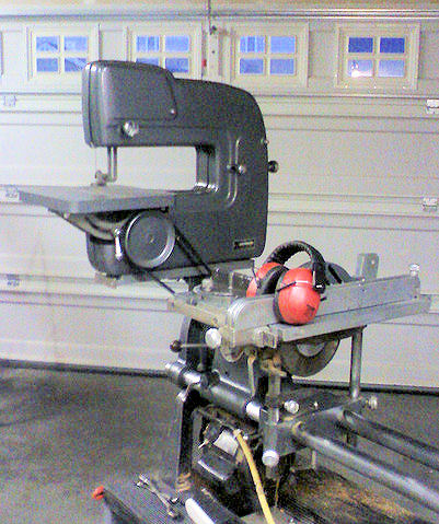

Back to the OP's query:
[ATTACH]23057[/ATTACH]
Some examples (likely came from this forum):
[ATTACH]23058[/ATTACH]
[ATTACH]23059[/ATTACH]

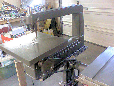

jere
Posts: 95
Joined: Sat Sep 15, 2012 7:42 am
Post by jere »
So here is my $20 scroll saw/jig saw run off of the SS. The saw vibrates like crazy but it makes really nice fine cuts. I had to make a piece to hold the lower half of the saw blade, and add some threads to some old bolts that were laying around. And a few other things, but for $20 bucks plus another $3 for the blades I am happy.
And hopefully Photobucket gets it's business together and rotates these pictures not sure why they show up sideways here. They are right side up on their site.

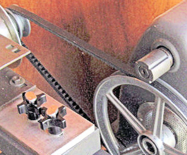

peterm
Posts: 576
Post by peterm »
Nice job. That v belt looks quite stiff though, so you might reduce vibration some (jigsaws are natural vibrators) by using a "link belt" or possibly a "notched belt" like in this photo:
[ATTACH]23065[/ATTACH]
Might be worth a try.;)
10-23-2013 10-01-27 AM.jpg (100.52 KiB) Viewed 1826 times
Peter
jere
Posts: 95
Post by jere »
Thanks for the tip about the belt. You are right about the existing belt being stiff. It doesn't like not being in an oval shape, and I the vibrations almost seem like they happen once per rotation. I have some link belt around to try so I will have to try it out
