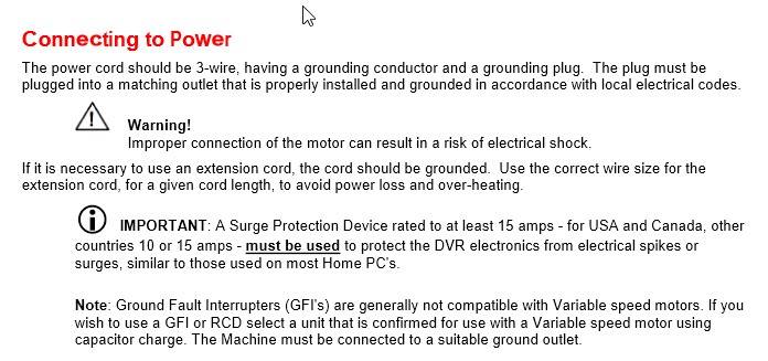

While I'm planning on being happy to run my powerpro without the need to go to 220 I did find it interesting that this was included in one of the Nova lathe manuals (DVR 2024).
[ATTACH]23158[/ATTACH]
So now I wonder since shopsmith doesn't have this warning can we assume that it doesn't need surge protection? It could have been built in I guess? Just wondering why that is not in our manual.
I personally keep the powerpro unplugged except for when I'm using it. All of our power and phone lines are underground so that does offer us some additional protection that others might not have....
I do have some power strips that I guess I could use as long as the current is below 15A. If I look deep enough I can most likely find some parts from way back when, when I made a few for myself. As I recall all you need is some MOV, chokes and some caps which I was able to get at radio shack but then that was a lot of years ago now....
So any way just want to add a bit to this quest.
ScreenHunter_90 Nov. 04 20.02.jpg (50.19 KiB) Viewed 2274 times
