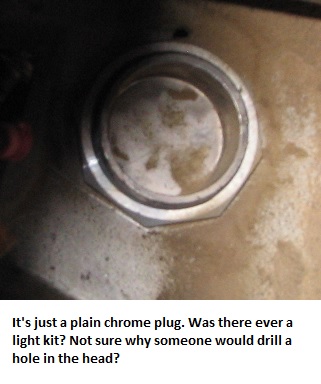

Update: Back side of plug pic
Post by dcohenour »
Ok, here is what the back side revealed. It looks like just a chrome plug, plugging a hole. Was there ever a light kit for these machines? I cannot fathom why someone would just drill a hole in the head, unless it has something to do with what looks like a repair. (See separate post).

My guess is that it could be an access hole to lubricate the control sheave and speed control assembly. Never saw a hole in this location. Might be an idea that did not pan out as I have had a few of those.

Yeah, I thought about that, IF you could pry it off from the front. Maybe that is what a previous owner was thinking. Now there is a nut on the back side.
What could I turn this hole into? How about a light hooked up to the power switch to let me know that it is on? hehe
