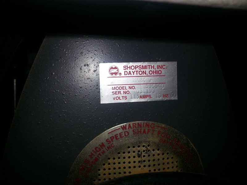

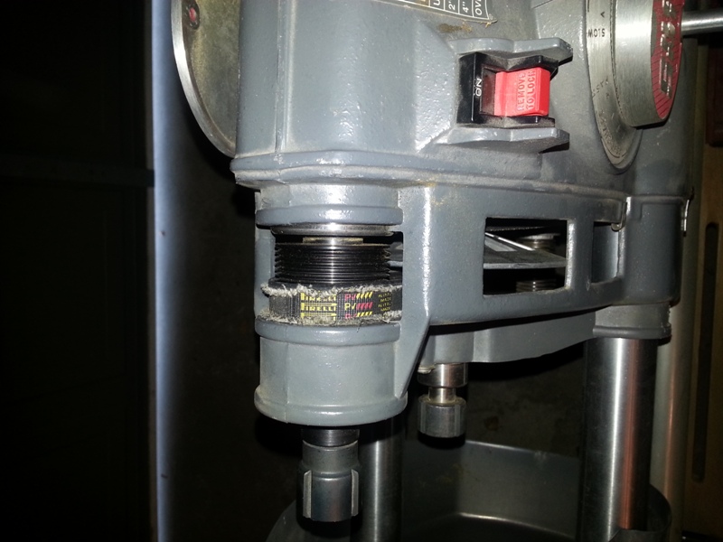

Here are some pictures I took last night, I can take better ones if you need them. I took them on my phone to show my Father in Law. I appreciate all your help and advice. So I am going to go forward with trying to move the speed dial to fast while I am manually spinning the sanding disk. And try to remove the motor belt. Once that is done I can turn on the motor to see if the belt was the problem is that correct?enyoc wrote:If you post some pictures of the headstock, including the serial number plate, the forum can help you determine if you have a poly-v or a gilmer. (the gilmer is toothed)
[ATTACH]23223[/ATTACH]
[ATTACH]23224[/ATTACH]
- SS Mark V Number.jpg (126.45 KiB) Viewed 1239 times
- SS MarkV Belt2.jpg (146.99 KiB) Viewed 1242 times
Your Mark V is from 11 March 93. It looks like to me that the poly V belt is in the WRONG position. That's why ya have the fraying on the belt. Once ya get the speed turned to FAST, ya can walk the belt off the sheave.

Wow just got through watching that 3rd video on the drive train. Very informative, and enjoyable to watch. I could use a few more close ups on it for the details, but still great resource. Anyone who can help identify if I have a Poly V belt or a Gilmer belt based on the pictures posted previously please let me know I'm going to place an order for them asap so I can get this thing running again. When I asked to borrow the ShopSmith from my Father in Law I thought it was in working order, so I have projects waiting. Thanks again for the insight and advice.
ryjonesacct
- Silver Member
- Posts: 17
- Joined: Sat Nov 09, 2013 11:50 pm
- Location: Salt Lake City, UT
So it is a Poly V belt and not the Gilmer? And I should probably replace both the poly V as well as the Drive belt right? After watching that Sawdust session video on the drive train I feel pretty good about tackling the job. Wish me Luckbeeg wrote:Your Mark V is from 11 March 93. It looks like to me that the poly V belt is in the WRONG position. That's why ya have the fraying on the belt. Once ya get the speed turned to FAST, ya can walk the belt off the sheave.
