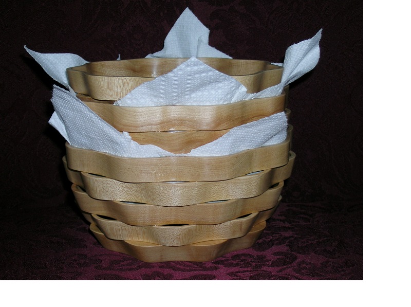

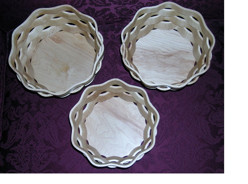

2013 Christmas projects

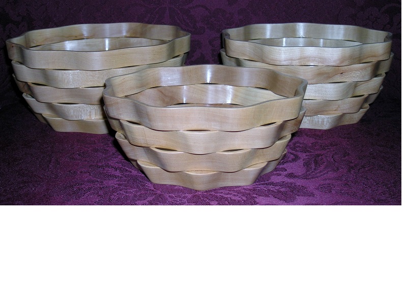

Three nested scroll saw baskets, all from one 9" x 26" maple board:

Great Looking baskets, tried them once but mine didn't turn out that nice. Someone will really love those.

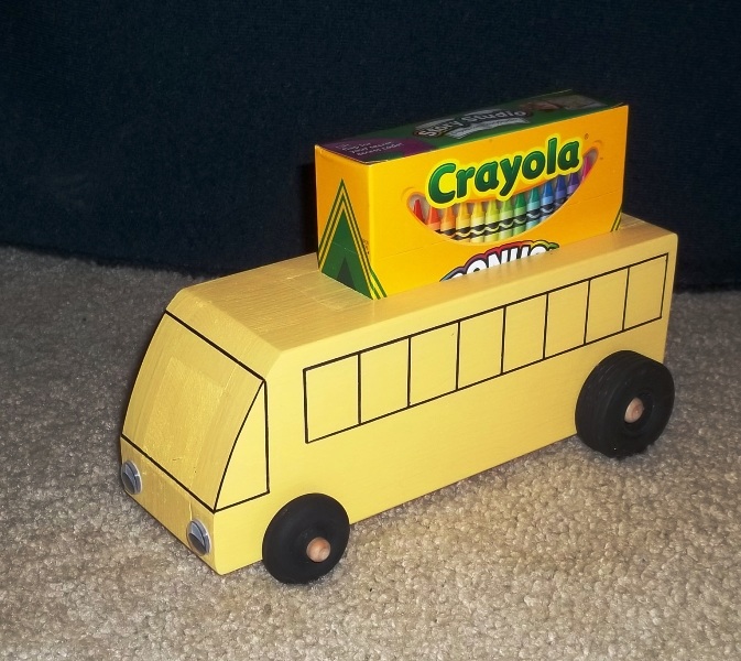

For the two year olds, and this is a VERY simple project I just threw together after not finding any plans that suited me. A single 1x4 of cheap "whitewood" and Hobby Lobby wheels/axle pegs and a can of yellow spray paint combined with a black Sharpie and....

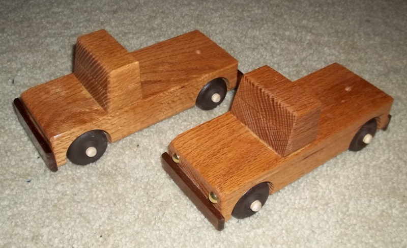

For the 5-year olds, a basic pick-up truck. It is scaled to go with the tractors they got last year, which hopefully will be followed by some farm trailers in the coming year. They are oak with each of the four trucks have bumpers made of different woods; bois d'arc, ebony, walnut and cocobolo. Again, wheels and axles courtesy of Hobby Lobby. Spray spar urethane finish after staining the wheels with dark walnut.....

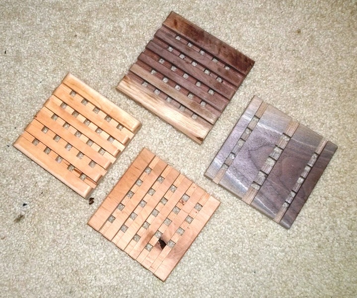

Last year all the women almost got into a fight over the jelly bean machine, so I learned my lesson and they all got a set of trivets this year. These are just a few of them. Again, simple design cut from square pieces of wood (oak, cherry and walnut) and using a dado and a bit of sanding. No finish because I expect these to be used and have hot pots on them often....

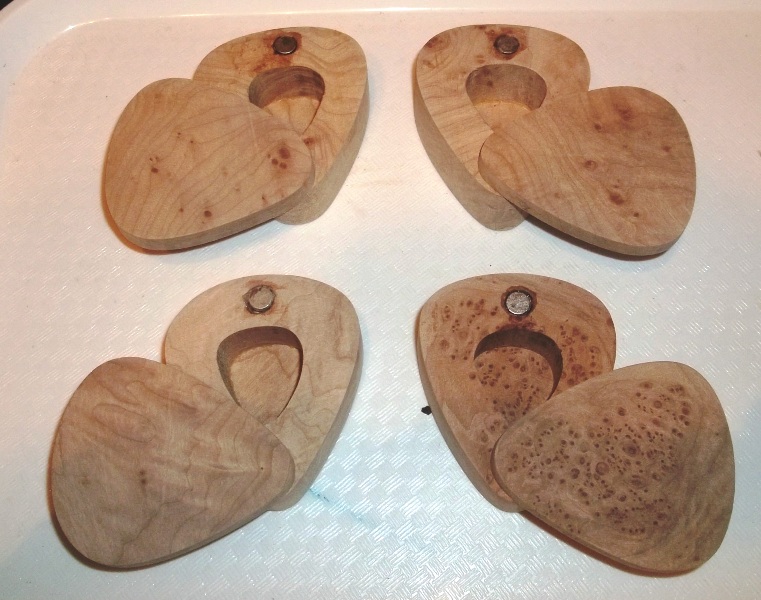

Some of the kith and kin are into guitar playing, so I stole this from Steve Ramsey, WoodWorking for Mere Mortals on youtube. Steve always has some great simple projects for us beginners. These were made from a piece of birdseye maple burl I've been hauling around through various moves for the past 20 years. Finally found a project worthy of them. I made some modifications (I think they are improvements) over the original design. These do not have a finish yet, but should look really good after tomorrow....

mrhart wrote:I give, whats the process here?I've never seen these before.
Way cool sir!!
Think 'Ring Master' but use a scroll saw and cut wavey circles(at an angle).
Would not a Band Saw work? Fergit I asked that!:o
The nesting baskets pattern was designed by Dave Van Ess and is included in the book "Creating Wooden Boxes on the Scroll Saw", copyright 2009 by Fox Chapel Publishing. Great book! I think this is the easiest project in the book, though going round and round with all the rings can get a bit tedious....
Thanks for the compliments. SWMBO likes it a lot. She's making chocolate chip cookies right now, so I guess we both win!
JPG is correct - the rings are concentric wavy circles and are cut at 5 different angles, the steepest angles for the bottom rings. It's a really ingenious, efficient design, there's only a small amount of unused wood out of the 9" x 26" board.
JPG- Each ring is cut apart along the grain and glued together, so I'd guess that it could also be cut with a bandsaw using maybe a 1/16" or 1/8" blade. The rings are only about 3/16" thick, though, so the rings might get too thin due to the thicker kerf of the bandsaw blade.
