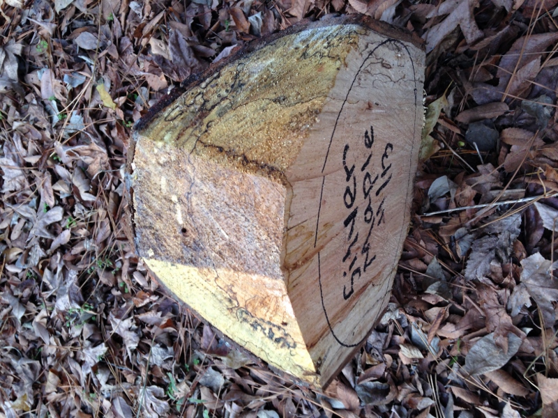

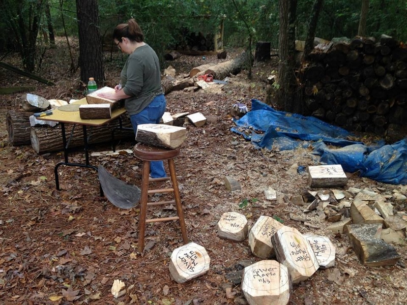

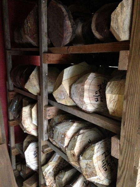

dgale wrote:Just so I'm sure I understand, when you say cut the log in half, do you mean cut it in half length-wise (like splitting firewood) or do you mean cut the log to length and otherwise keep it round?
Yes like splitting firewood.. I attached a picture of one half of a log and another picture of the storage shed with bowl blanks in it. PLUS a picture of my lovely wife helping prepare bowl blanks !~!~! She's not much into woodworking but agreed to help with this task. This day we put 32 bowl blanks into the storage shed to dry.
