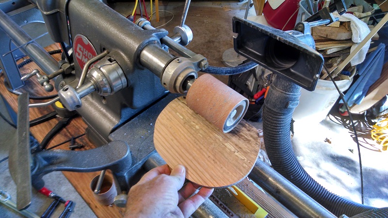

[ATTACH]23837[/ATTACH]
Using my large drum sander to sand outside of box.

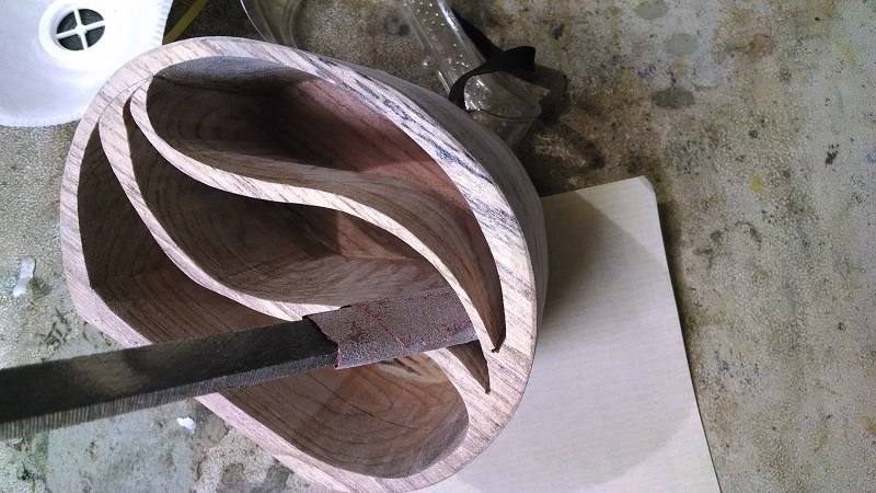

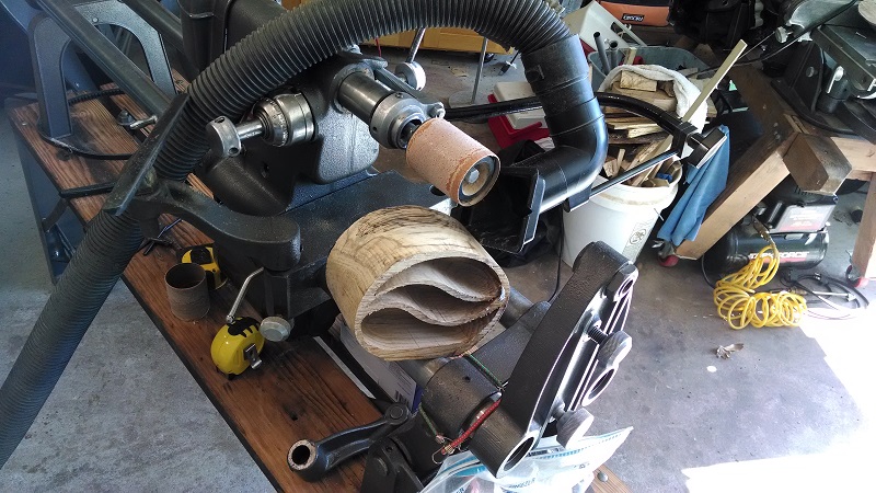

[ATTACH]23838[/ATTACH]
Used a small drum sander to sand insides.

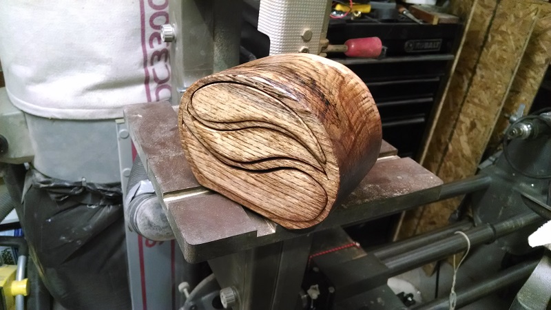

[ATTACH]23839[/ATTACH]
Sanding the back plate.

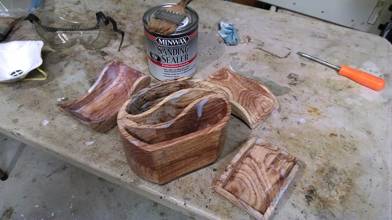

[ATTACH]23840[/ATTACH]
Applying Sanding sealer. Not sure if it was necessary but I did it anyway.

Super glued a strip of sanding paper to piece of wood to get to the insides in tight areas. Otherwise I just folded a piece of sandpaper and wedged it into the tight areas.

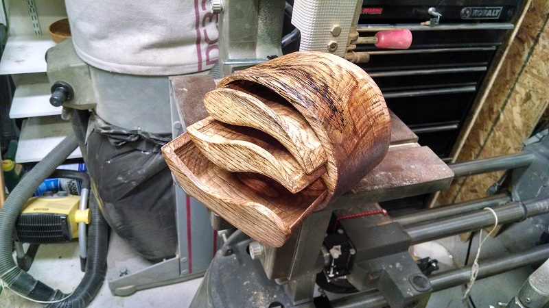

Applied Danish Oil and then Friction Polish. I will be adding red felt to the insides of the drawers.
[attach]23843[/attach]
Last step will be to cut out and attach some handles. Not sure I like the finish look, but this was a prototype anyway. I used the pith of my oak logs and they seemed to work ok, no cracks yet. I have to say there is a lot more work required to make one of these compared to turning a bowl. I had to do lots of hand sanding to get things smooth.
