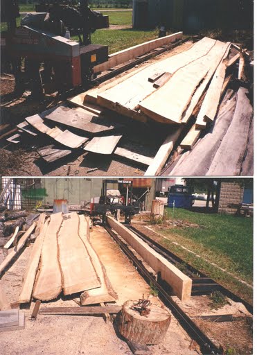

It is a lot tougher than that. I once cut two 24' long runners out of it to move a historic smallish (about 20' x 24') former post office about a quarter mile down the road ( I used to take on all manner of odd stuff
