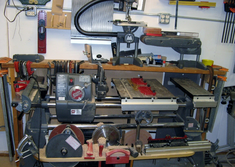

Faced with a very limited space I purchased a Shopsmith in February of 2011. My previous shop had lots of room with freestanding machines. For me this created a steep learning curve. Although it seems that every tine I use the SS I find a new way to use this versatile tool. I also find this versatility can be frustrating. Over all I find the Shopsmith an excellent machine for the space available.
Last night I cut a 30in X 6in oak board in 4 strips then put a 1/2 in grove in each strip without the dust collector connected.
Picture 1 shows the machined strips with the SS in the pulled out working position and the piles of sawdust all over the place. The approximate working footprint including the freestanding band saw is approximately 9ft x 4 ft.

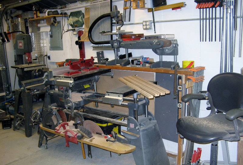

The second picture is the opposite angle for the working position.

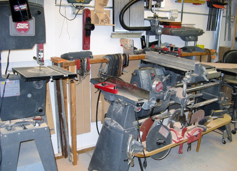

The third picture is of the SS in the stored position approximately 6ft X 28in.

If you were trying to make a point regarding the value of dust collection- you have certainly succeeded.:) The dust collector , if it does nothing else, reduced the time required to clean up.:rolleyes:
Nice shop.
