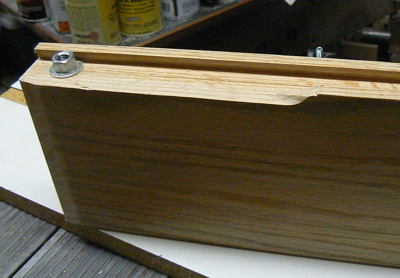

Well someone neglected to add 3/4"(the base height) to the 2x6 height(5 1/2") and realize that exceeds the thickness range of the bandsaw.
Step one was to reduce the jig height where it needs to pass under the upper glade guide stuff.
Still a problem with the pivot post 'nut', but by starting the cutting with it just past the 'stuff', it will not interfere. This was a blessing in disguise, as it provided a stop for loading the work piece(2 x 6) into the jig.
So after the 'tweaking' the jig now looks like this.
[ATTACH]24076[/ATTACH]

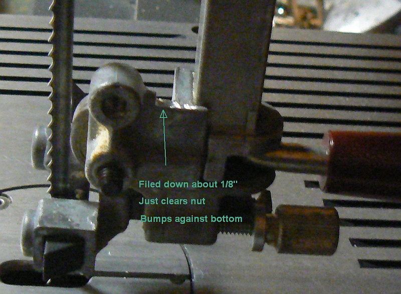

That still did not allow for the 2 x 6 to clear the upper guide stuff, so a look see at what was restricting the height led to this modification. I filed about 1/8" from the part that was hitting the bottom of the upper guide bearing structure. Alas this only resulted in 6 1/8" clearance.
[ATTACH]24079[/ATTACH]
So I bit the bullet and hacked off 1/8" from the side of the 2x6's so they would clear. Crude, but the radiant heater yesterday was 'setting in the west' and I wanted to get this done. Do not ask why outdoors.

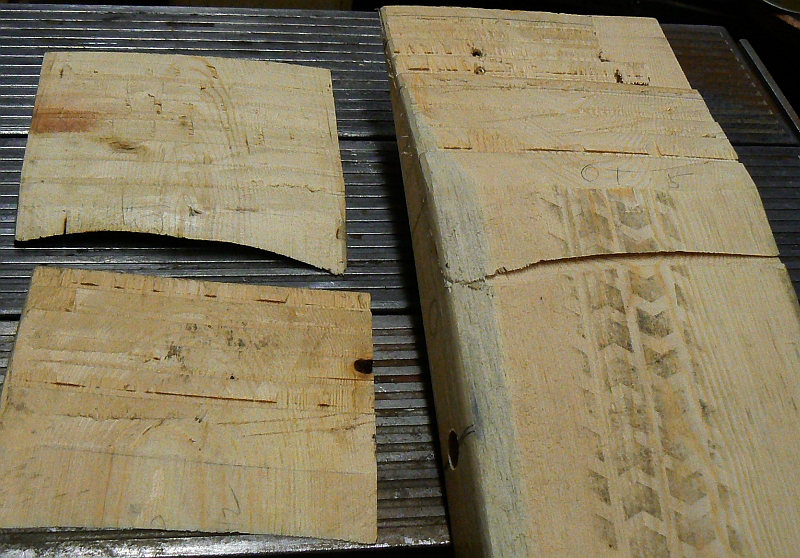

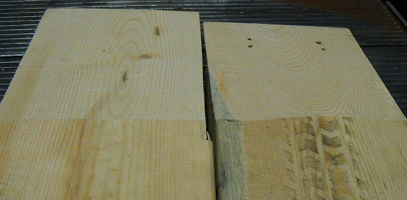

Finally here be before and after pix of the 2x6 at the acute angle cut.
Before surfaces were cut then 'hand planed' down and looked like beaver tracks. No the tire tracks are not relevant here.
[ATTACH]24077[/ATTACH]
Much better looking today. There are six 2 x 6 with this cut on both ends.
[ATTACH]24078[/ATTACH]

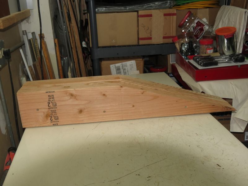

The ramp reminds me of a project I did about 20 something years ago.
In my case I needed a short ramp to get under my Escort to change the oil and filter a little easier.
My solution was to get (4) 2x6 then glue and screw them together making sure I didn't put any screws along the diagonal line I had drawn. When it had sat long enough for the glue to dry I then used a circular saw to cut on the line, first on one side then flip and do the other side. When the cut was done I had two ramps.
This is what they look like:
[ATTACH]24082[/ATTACH]
Never bothered to plane or sand the ramp as they are only a utilitarian object. I guess I could have slopped some paint on them....
