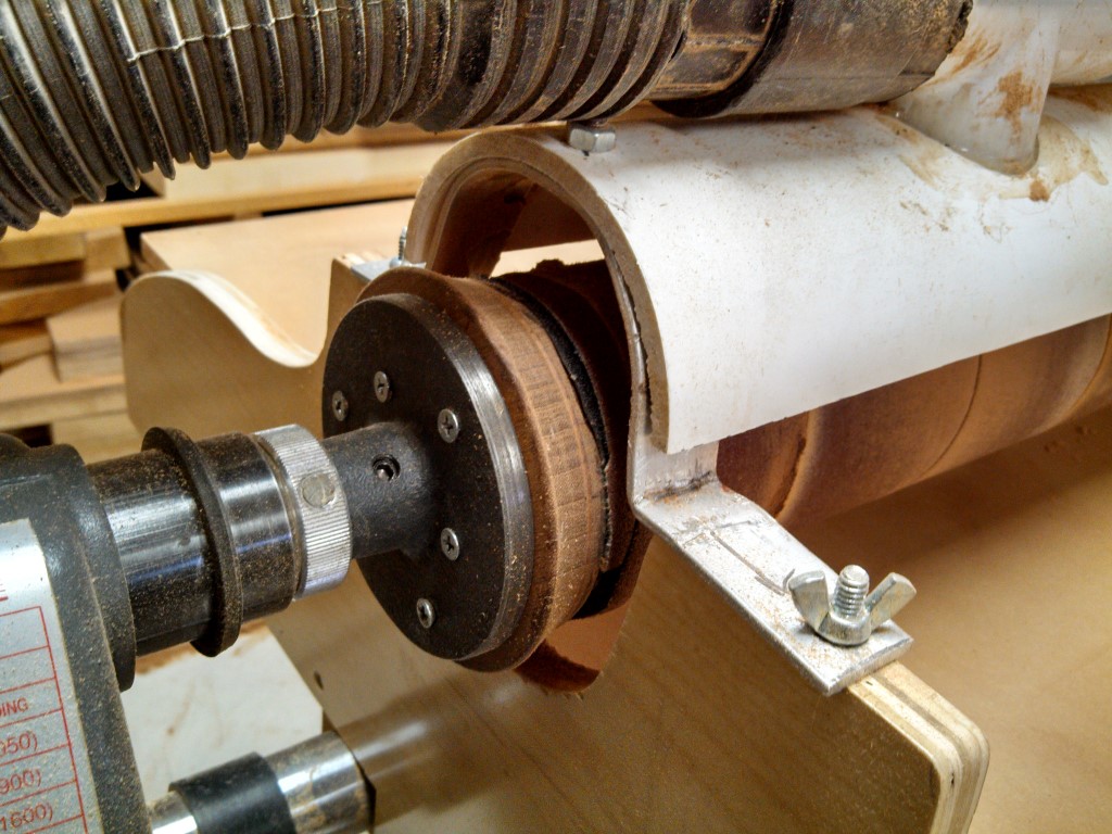

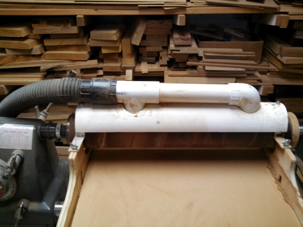

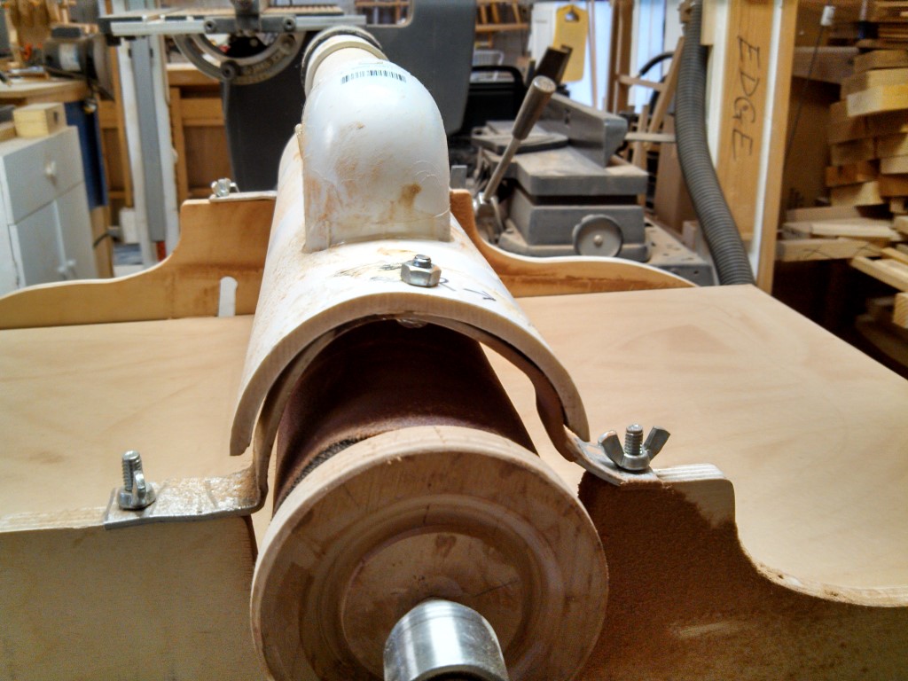

the sanding drum is a pvc pipe. I turn the ends. no problem in raising the table there a screw in the front pushing the table up. I push from the opposite side so it doesn't shoot it.
farley wrote:here are a couple of shots.
I believe the dust collector would work better lower to the drum, but I had such a time bending the metal, that I accepted it. Would like to redo it, but know I probably won't ever.
Move the bracket to the outside.;)
