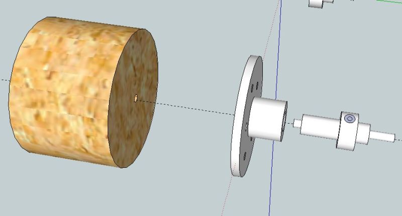

Kind of confused by the duplicitous center dowel. And yes I did mean duplicitous since one dowel is pointy, yet the one shown in the initial rendering is not! Me thinks thou is leaving out a critical if not crucial key.
Okay, so I truly have not a clue!:D I do wonder why the one cylinder has a stop collar and the inner dowel is presumedly allowed to turn and move freely (pointy ended or not).
If the inner dowel "is" driven, maybe by a drill chuck or chuck I have less of an idea.:confused: Hmmm, if I have no clue nor idea could I have less than that? Who on the forum has a Piled higher and Deeper in Philosophy that could shed some light on that question. :rolleyes:
Do we get dimensions, or would that give it away? To others that is, since I'd still be clueless!

A mandrel of some sort for wood turning... ??
Live center?
The "collar" with what appears to be a set screw makes me think it's meant to have an adjustable depth/length. But the center "pin" appears to be free floating. hmmmm...
Can we get dimensions?

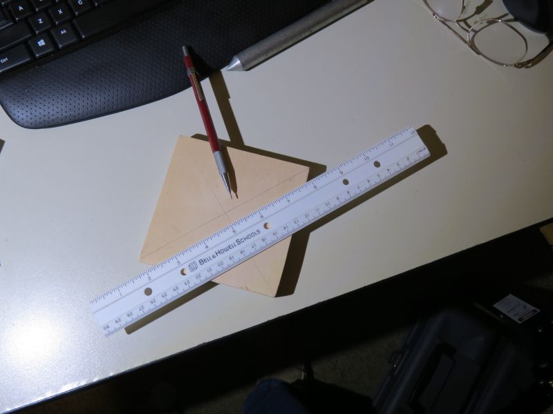

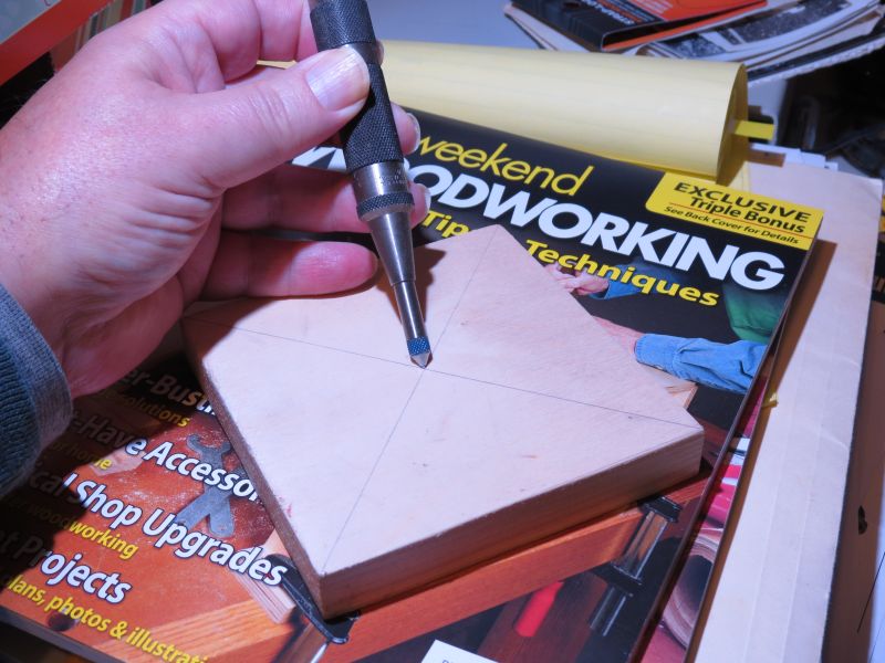

By way of an example the following pictures show a chunk of wood that I wish to center before I put it on the lathe. I have a square piece of Baltic plywood but this could just as well be a bowl blank or anything else that could be mounted with a face plate. I have also pictured the 3-3/4" shopsmith aluminum faceplate.
The first picture is the blank with diagonal corner to corner lines drawn. This should come out to be the center or very close. If this were round to start with then other methods would be need to locate the geometric center.
[ATTACH]24093[/ATTACH]
This next image show using an auto center punch to physical locate the center. Some other means might be to drill a hole or even do nothing. I'm using the center punch because I want the point to be a physical place.
[ATTACH]24094[/ATTACH]

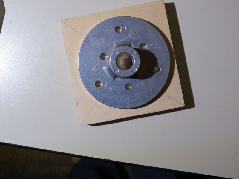

Now with either the hole or just the lines it is time to put the faceplate on the center point. I found it difficult to visually locate the spot looking through the hole and trying to get it right on. Some people are going to be better at this then others.
[ATTACH]24095[/ATTACH]

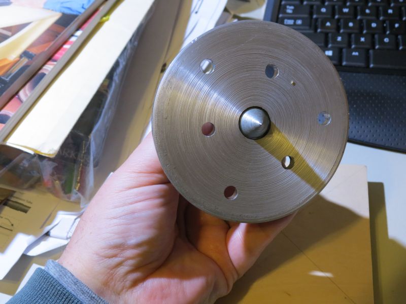

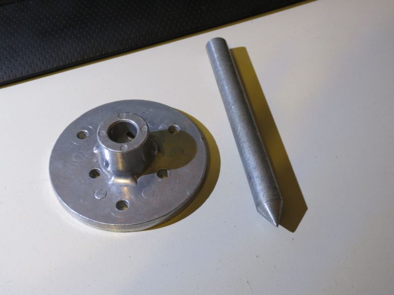

Since this was an issue for me I addressed this with a bar ground to a tip as can be seen here. The bar needs to fit the shaft and that is about it. The angle could have a large range and is not critical.
[ATTACH]24096[/ATTACH]
This is certainly something most of us here can make. While you do need to grind to get the center on center getting it close on a grinder by hand can be done but I like to do the finishing touches with the lathe which will require additional tooling. If you set up the grinder with a angled edge I think you can just do it that way... I've not tried. The result is to have a center point that is centered to the faceplate as shown.
[ATTACH]24097[/ATTACH]

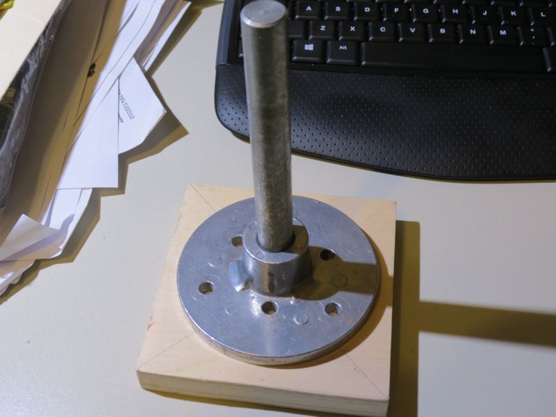

This next image is the use of the center to find the center punched hole thus centering the faceplate and workpiece.
[ATTACH]24098[/ATTACH]

You can go read it or not, the next part of this post is dealing with the addition of a 1/4" hole to the centering of the shopsmith faceplate and is independent of the carter jig unless you like me have one. In that case please read that thread as it will become relevant later.
If we go back to the shopsmith faceplates they can be useful for a lot of projects. In some cases direct mounting to them or by adding a wood facing and mounting you projects to that. Back when I was first introduced to wood lathes chucks were not around, at least not in home shops or in the high school workshop. Most of my lathe work on the shopsmith was with faceplates until I got a Nova chuck not so many years ago. I still see certain projects a faceplate projects even now. So to me I want to keep this aspect as part of my woodworking.
Without getting into too much detail it is nice to have a small hole to use as a locator. When using the circle cutter I fond that a 1/4" works better then the pointed end when cutting the circle. This is also true when using a router to round a shape, the 1/4" pin helps the circle cutting and provide a common point for lathe work.
When I started this design I wanted to make use of a 1/4" rod that would use the 1/4" hole that was there from the creation of the rounded piece. It also made since to have a pointed version for center punched times. It also made since to have a shaft that would fit the hole in the faceplate, the same 5/8" of the shopsmith shaft. I though it well to provide a stop collar because of the differences in faceplates. Better to have a fixed place to stop then an unknown one. The stop collar also works well to have something to hold on to when using it.
[ATTACH]24099[/ATTACH]
The image show how this works. No rocket science here. Like I said I have one to experiment with in a week or so. If I like it then I will be willing to provide dimensions in case someone wants to build one like it.
