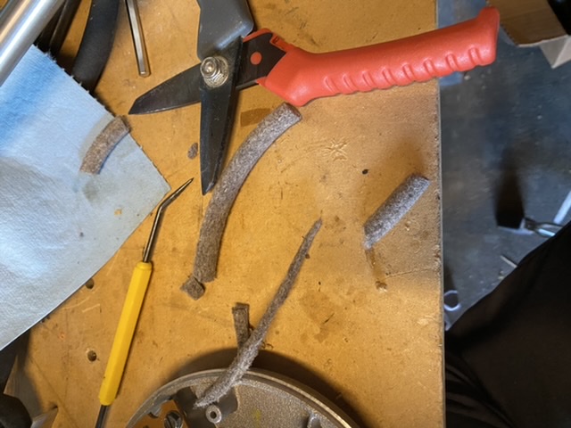

Cutting up the wool cord.
So I removed all the old material that was in the bearing and got some pressed wool cord, which I cut up and stuff back in. Hopefully it works out well....

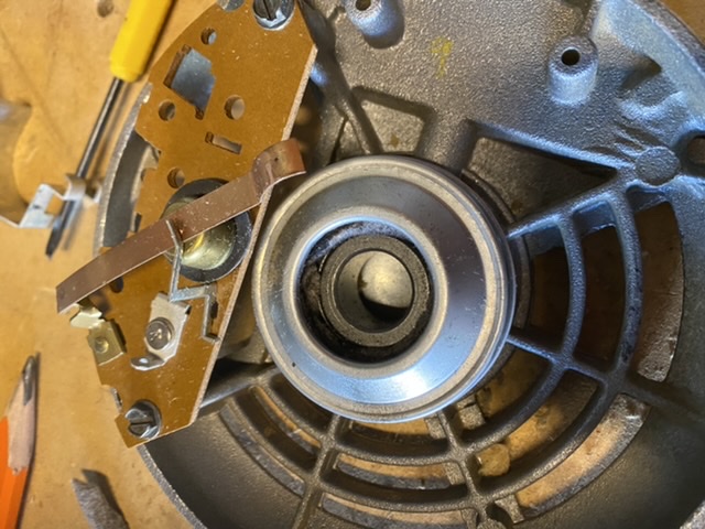

Replaced the 6203 bearing with a new one, however when I was putting the snap ring back in place, it broke! Anyone know the size or part number for this snap ring? My calipers measure the the area of the rotor where the snap ring rests is approximately 16mm
Repacked bearing with wool + oil
