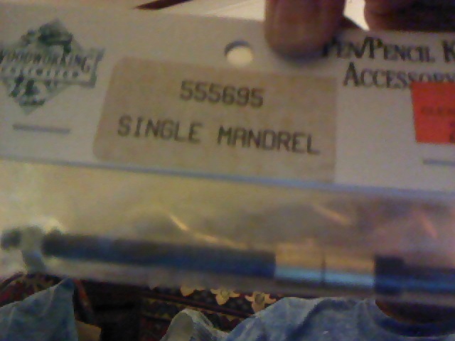

I bought a used Mark V back in February and some new single mandrels for pen/pencil turning came with it. They are from the old Shopsmith stores (Woodworking Unlimited) and the serial number listed on the package is 555695. Does anyone know what do I need in order use them on my SS? Can I mount it using the chuck and use the live center with it? I enclosed a pic I took from my webcam. Thanks.

Yes, you can mount that mandrel in the drill chuck, unless the other end looks like this one, then it would mount directly to the Shopsmith. The live tailstock center fits into the dimple in the end of the mandrel.

Thanks. It doesn't have the endpiece like that. I'll have to use the chuck and live center. I was looking at the one you listed. I may get that one later on. I appreciate it. Now I'm wondering what drill bit size to use to make blanks!Mike907 wrote:Yes, you can mount that mandrel in the drill chuck, unless the other end looks like this one, then it would mount directly to the Shopsmith. The live tailstock center fits into the dimple in the end of the mandrel.

As Mike stated, it all depends on the size of the tube. Bushings are then used to make up the difference between the mandrel and Inside diameter of the tube.
