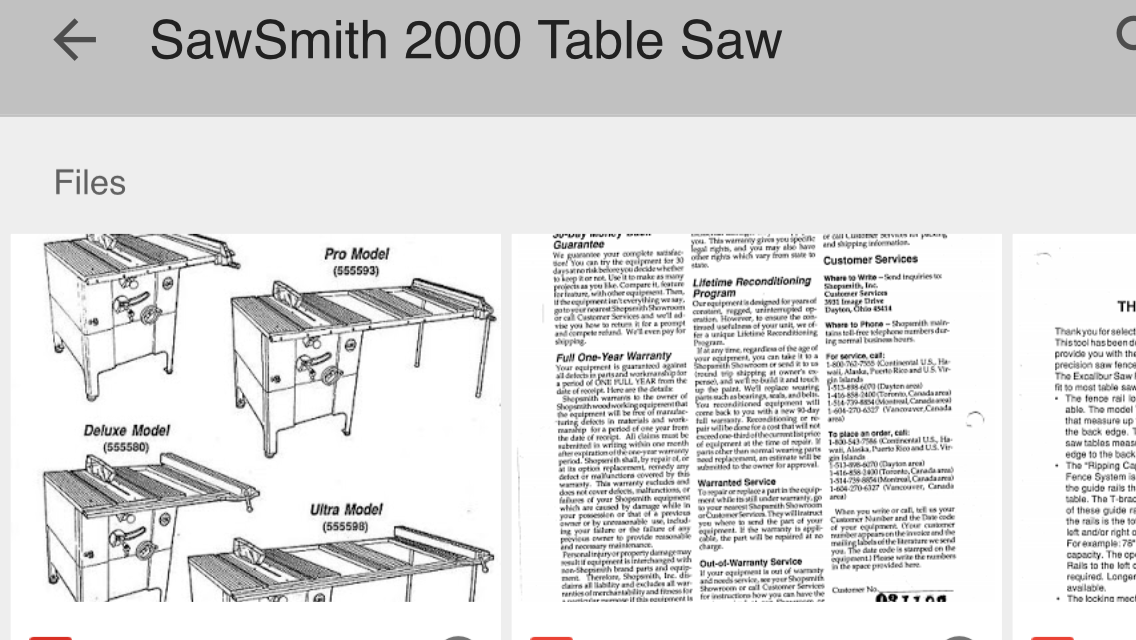

What few documents I have collected on the SawSmith 2000 are in a folder on My Google Drive link
Everett

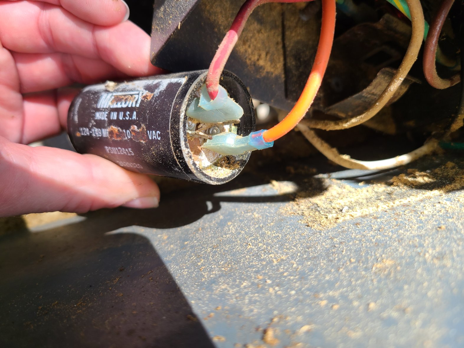

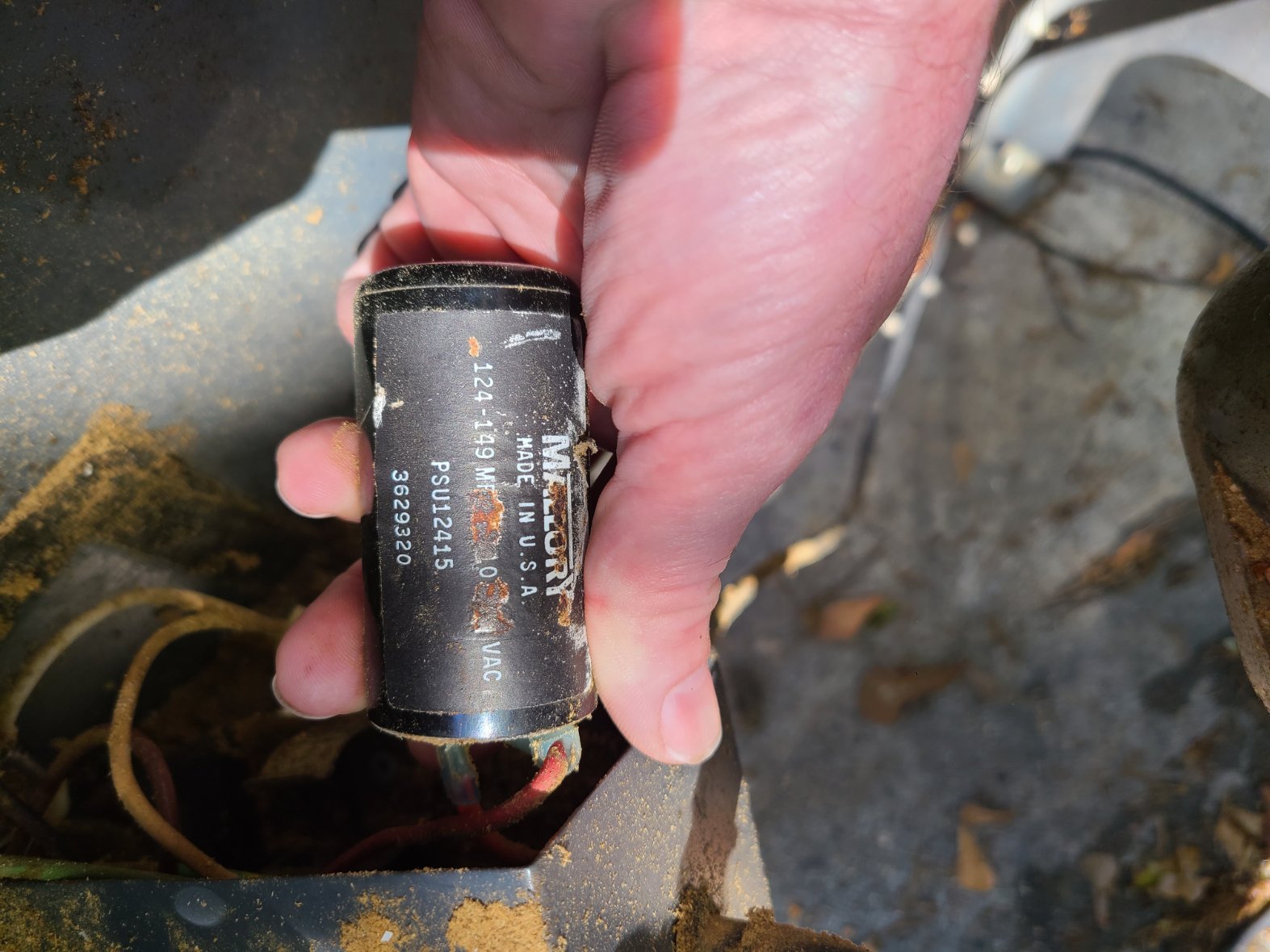

mauione wrote: Mon Feb 02, 2015 10:21 am I just pick one up yesterday. Same thing, the Cambridge plastic broke, as soon as I turned it. So brittle. Also, can you look at the start capacitor, as mine is missing and I have no clue to what size or what wires plugin to what.
Thanks for your help
The capacitor is a Mallory psu12415
Re: Sawsmith 2000 (not RAS) owner is looking for some parts.
The important # are the 124 - 149 mfd.
The voltage rating should be typical for a 120v motor.
