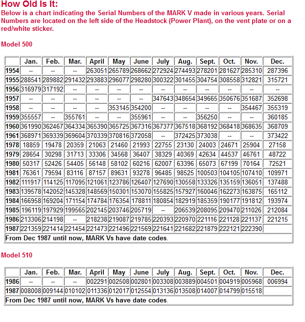

The production chart that I most frequently refer to indicates that units with serial numbers greater than 190000 began production sometime in the Sept-October 1984 time frame.rbursek wrote:He emailed the S# it is Mark V-B 202442 which would make it produced in April -May 1985, that should have a dual bearing quill right?
[ATTACH]24827[/ATTACH]
- Capture, How Old is It.PNG (67.64 KiB) Viewed 1689 times
rbursek wrote:Most likely, but the SS S# site and Mickyds both agree it was made in April-May of 85. I just got an email from the seller, it has a smooth grey finish, so I am confused!!! I hate conflicting details. BTW, Good morning Dusty!!
My suspicion about some of these apparent contradictions is that some units were produced using "old" parts still in inventory at the time of an upgrade or design change.
Example: A headstock casing that had been painted smooth gray would not be discarded simply because newer headstocks were being painted rough-gray. If this happened, it would explain many of the contradictions of detail.
Good Morning to all.
PS: We must also remember that many of the units we discuss here are units that have been around a long time and in the hands of more than one owner. Each of these owners could have made changes that deviate from the original production configuration. Changing out quills is an example that immediate comes to mind.
I would not bet that the two machines that I have are currently configured with their original quills. I have had both headstocks in a state of disassembly at the same time. There is no guarantee that they went back together with their original parts.

Just confused with the conflicting facts, smooth grey, but SN indicates by other info it should be hammered/rough, owner sez bought in 83, SN indicates other. I dont like inconsistencies.
To avoid inconsistencies in matters related to Mark 5/v configurations, you will probably need to quit cross referencing these details. Otherwise, inconsistencies will prevail.rbursek wrote:Just confused with the conflicting facts, smooth grey, but SN indicates by other info it should be hammered/rough, owner sez bought in 83, SN indicates other. I dont like inconsistencies.

Then that must mean the info on these various sites/threads is inaccurate, even the one from SS itself with the serial numbers and model change descriptions above it, if in fact that is the original PH on the machine in question. If in fact it is the original, then the info here to this topic has no validity, which makes it useless. "I met him on the internet, he said he is a French Model"
http://www.shopsmith.com/ownersite/faq/markv.htm
I certainly did not mean to say that the information is inaccurate but I do contend that when inconsistencies do exist, it is not surprising. The Shopsmith has a much varied back ground, having been built by more than one manufacturer, over a long period of time, with breaks in construction periods when the business changed hands..rbursek wrote:Then that must mean the info on these various sites/threads is inaccurate, even the one from SS itself with the serial numbers and model change descriptions above it, if in fact that is the original PH on the machine in question. If in fact it is the original, then the info here to this topic has no validity, which makes it useless. "I met him on the internet, he said he is a French Model"

Agreed, and I may find out from the owner today if he is the original one that it in fact was bought in 83, and for some reason there was warranty work done on the PH and that in fact is why the discrepancy, exp warranty work, sent a new PH made in 85 and put in the old housing to match the rest of the machine but put a current SN tag on it.
