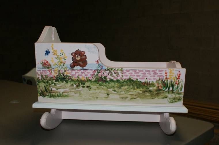

I can get precision cuts with my SS in table saw mode and with the stock miter gauge. First is to make sure that the entire system is properly calibrated and tuned. I used the term system intentionally as I believe that the Shopsmith, whatever the model, should be viewed as a system. We (the woodworking club) in our retirement community build a bunch of toys for the Toys for Tots program every year. The doll cradles are from one of the SS project books and do require some close tolerance cuts. Jigs are a absolute must. The head and foot boards require angled cuts but I only use one setup to make 80 cuts for the 20 cradles. I find that the ability to move the saw blade to sneak up on the cuts to be one of the most useful aspects of the SS system. This little cradle that we make can teach a novice a LOT of woodworking. We use the table saw function for straight, beveled, and angled cuts. The bandsaw for the curved cuts and the belt sander to refine the bandsaw cuts and the drum sander to refine the curved cuts.
For a 1/32" adjustment try moving the sawblade rather than the fence.
[ATTACH]24841[/ATTACH]
