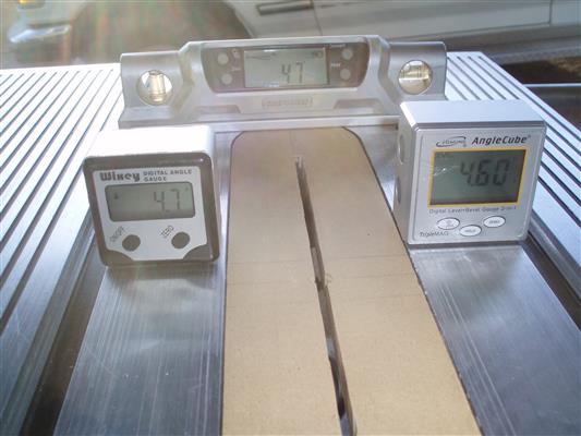

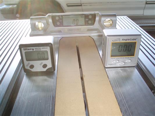

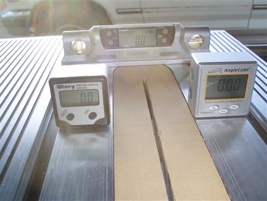

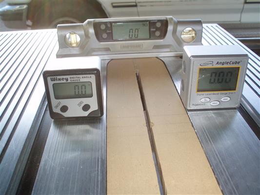

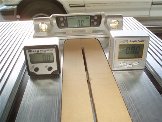

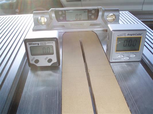

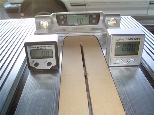

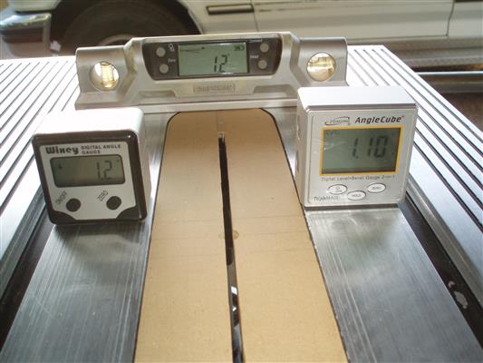

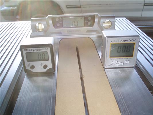

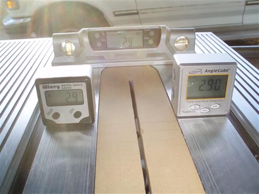

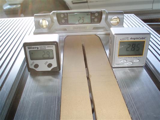

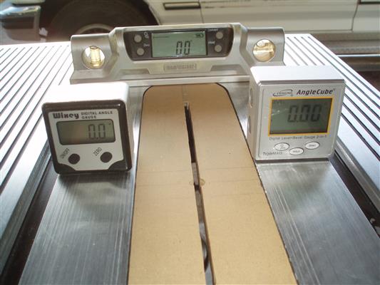

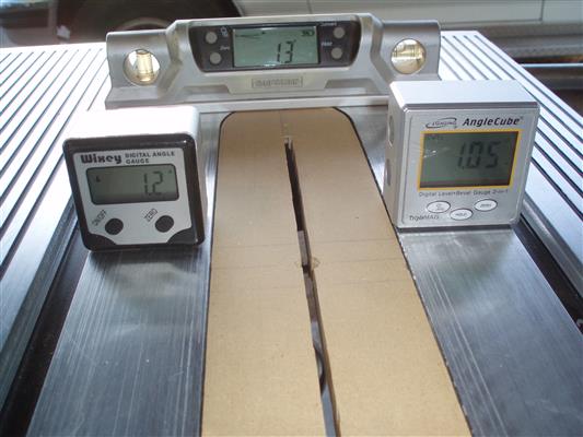

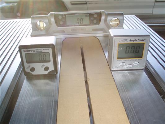

I have finally gotten around to playing with the angle indicators but that is about all I can say.
With the exception thateach, by themselves, is consistent. The problem is that when comparing one against another, the results are a bit confusing.
I'll post three sets of five pictures each to show what I mean.
In each set of five the table is first positioned at "no tilt" followed by "tilted" followed by "no tilt" followed by "tilted" followed by "no tilt".
Note how repeatable the observations are at no tilt.
[ATTACH]24947[/ATTACH] [ATTACH]24948[/ATTACH]
[ATTACH]24949[/ATTACH] [ATTACH]24950[/ATTACH]
[ATTACH]24951[/ATTACH]
- Angle Indicator Comparison 001 (Custom).JPG (41.06 KiB) Viewed 4990 times
- Angle Indicator Comparison 002 (Custom).JPG (40.92 KiB) Viewed 4990 times
- Angle Indicator Comparison 003 (Custom).JPG (40.72 KiB) Viewed 4993 times
- Angle Indicator Comparison 004 (Custom).JPG (41.35 KiB) Viewed 4991 times
- Angle Indicator Comparison 005 (Custom).JPG (41.04 KiB) Viewed 4991 times

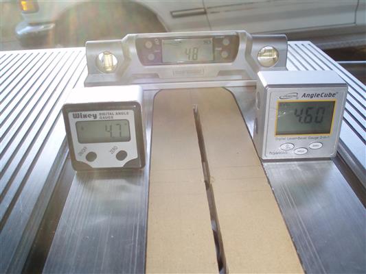

iGaging Angle Cube vs Wixey
Second Set of Five
[ATTACH]24952[/ATTACH] [ATTACH]24953[/ATTACH]
[ATTACH]24954[/ATTACH] [ATTACH]24955[/ATTACH]
[ATTACH]24956[/ATTACH]
- Angle Indicator Comparison 006 (Custom).JPG (40.43 KiB) Viewed 4990 times
- Angle Indicator Comparison 007 (Custom).JPG (39.7 KiB) Viewed 4993 times
- Angle Indicator Comparison 008 (Custom).JPG (38.71 KiB) Viewed 4990 times
- Angle Indicator Comparison 009 (Custom).JPG (37.8 KiB) Viewed 4991 times
- Angle Indicator Comparison 010 (Custom).JPG (38.21 KiB) Viewed 4989 times
Third Set of Five
[attach]24957[/attach] [attach]24958[/attach]
[attach]24959[/attach] [attach]24960[/attach]
[attach]24961[/attach]
- Angle Indicator Comparison 011 (Custom).JPG (37.81 KiB) Viewed 4992 times
- Angle Indicator Comparison 012 (Custom).JPG (37.92 KiB) Viewed 4995 times
- Angle Indicator Comparison 013 (Custom).JPG (38.03 KiB) Viewed 4992 times
- Angle Indicator Comparison 014 (Custom).JPG (38.1 KiB) Viewed 4992 times
- Angle Indicator Comparison 015 (Custom).JPG (37.98 KiB) Viewed 4996 times

All within +- .1° except one +-2°.
Since done on an aluminum surface, I wonder if on a steel table they would be more consistent.
I think the gimbal bearings are the most likely thing to cause deviations.(assuming they have them) I do not know about the internals. The iGauge has to me been 'stickey'.
At first I thought the two tilts in each set were opposite direction, but closer look shows tilt always left side up.
I am curious how you determined the degree of tilt in each case. Dusty tilt adjuster nut fractional turns?
