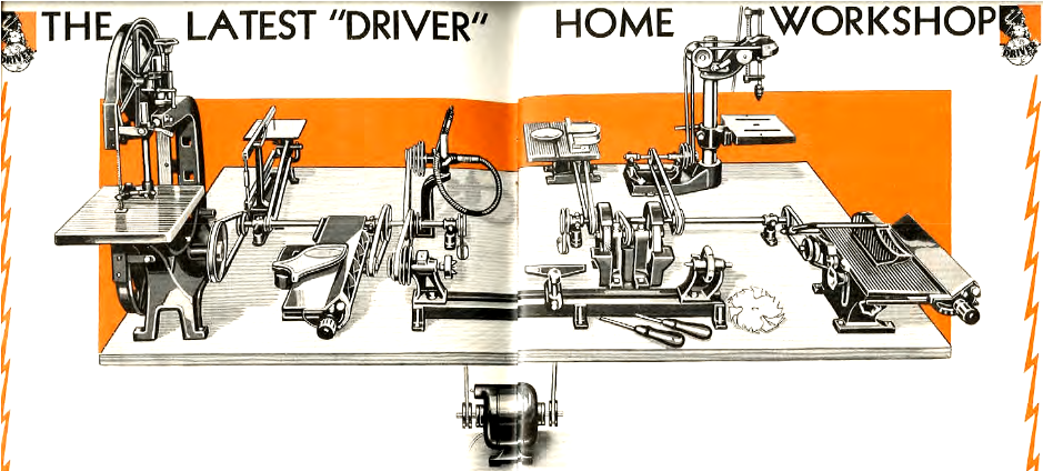

Bench Grinder: Sears Companion No. 4. Appears in the 1932-1939 Sears power tool catalog. A new design for the belt driven 4" grinder appeared in the 1940 catalog. Initially part of the "Driver" line of belt driven tools from Sears. The "Driver" concept is illustrated in the attached image.
