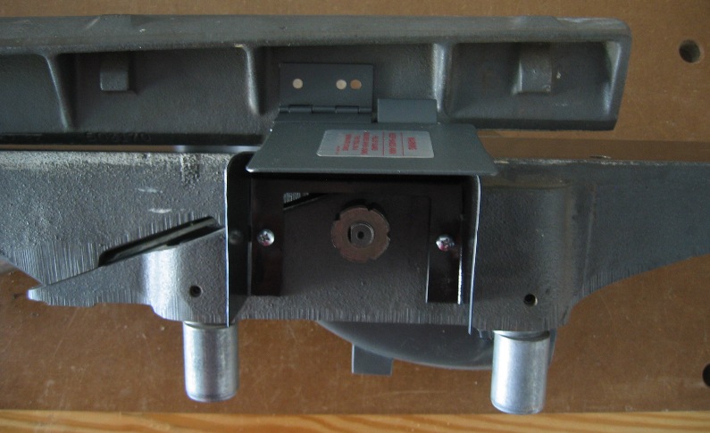

I think JPG nailed it with the observation that what really matters is the fence will tilt without interference. I temporarily installed the guard with double sided tape and put it through all of the positions and it seems to work well with the third hole aligned so that is what I will go with. My jointer was purchased in early 1977 and is clearly different from the more recent versions.
Thanks to all.
[ATTACH]25019[/ATTACH]

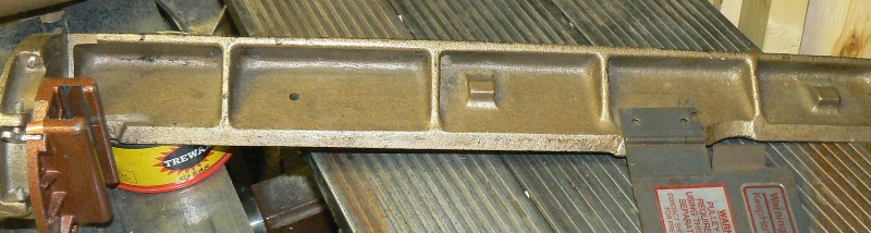

Here is a 'wide view' of my jointer fence and the unmounted flapping guard. It shows the location of both accessory holes.
[ATTACH]25042[/ATTACH]
If someone wants dimensions, I will do that!
