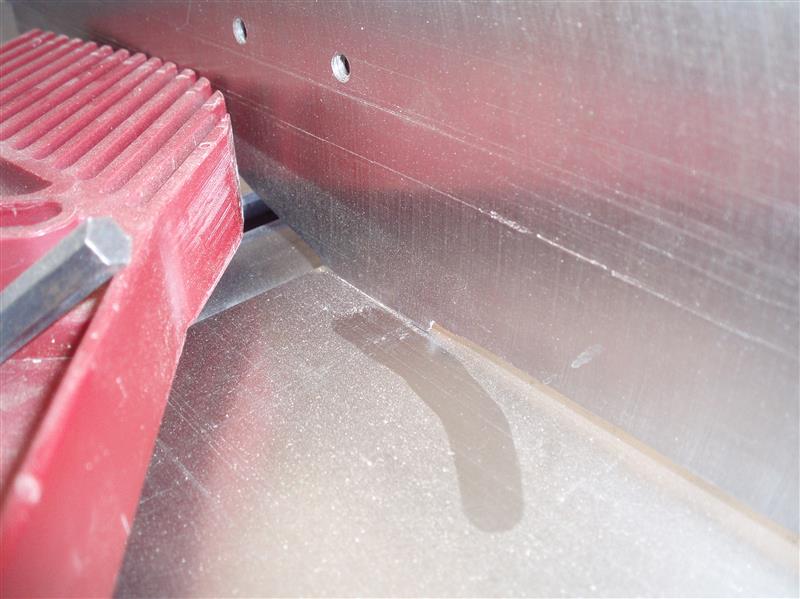

Ok so I replaced the jointer fence quadrant and now my fence looks like JPG's fence when the clamp is tightened. Not overtightened. I have decided to leave the lock handle loose until I need the jointer again. Just a guess but it looks like the constant pressure on the quadrant from the fence being lifted off the table could cause the quadrant to bend. Guess it will take about 20 years to find out though.:D
Bill V
wa2crk wrote:Ok so I replaced the jointer fence quadrant and now my fence looks like JPG's fence when the clamp is tightened. Not overtightened. I have decided to leave the lock handle loose until I need the jointer again. Just a guess but it looks like the constant pressure on the quadrant from the fence being lifted off the table could cause the quadrant to bend. Guess it will take about 20 years to find out though.:D
Bill V
Just 'snugged' should keep it from sliding astray. I would tighten it slightly before moving the jointer on/off the SS. However removing the fence makes it lighter!!!;)
Bill V
I guess my setup must also be correct because it also looks just like JPGs]25108[/ATTACH]
Jointer Fence 002 (Custom).JPG (65.33 KiB) Viewed 1789 times
Minimal force raises mine off the table.
