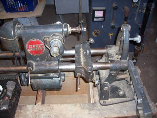

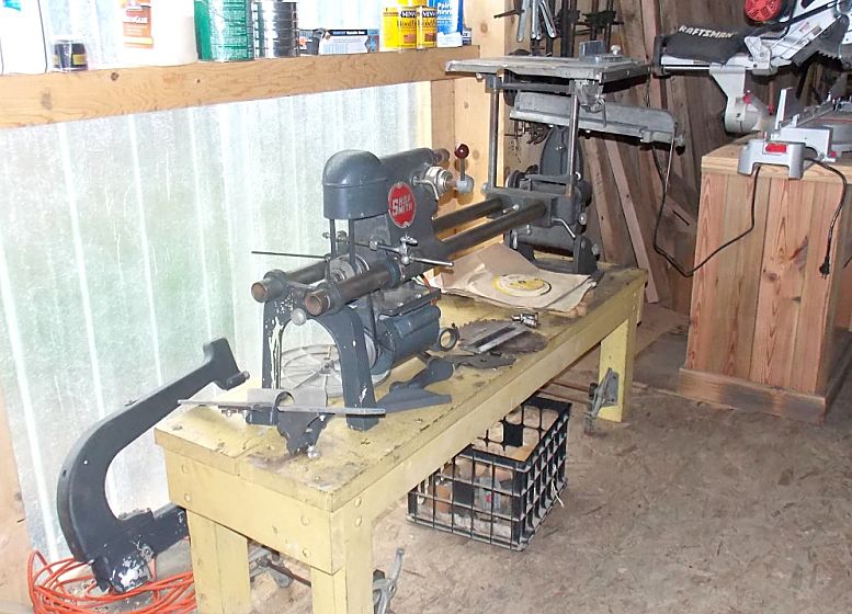

Ok,As long as we're talking ER's;My two have the serials#s of ER 19469 for thew one without the speedchanger and ER38817 for the one with the speed changer.Anyone care to offer an educated guess as to their year of manufacture?

Hi,
From my listing I see #19102 listed as March 1950 so yours has to be very close to that. The 38817 would be later that same year or possibly early 1951.
