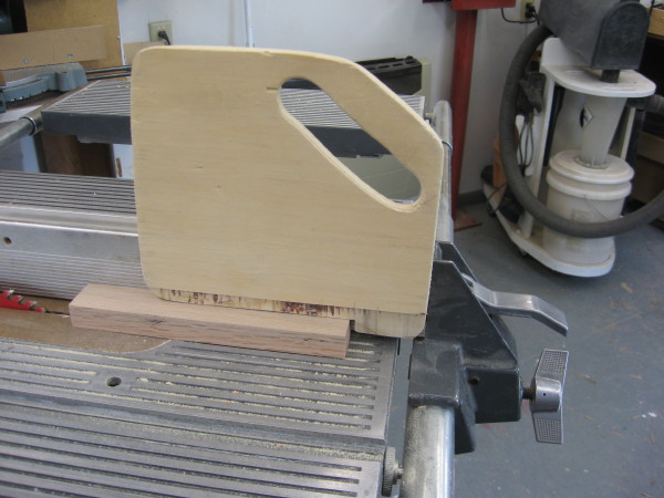

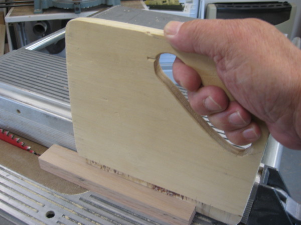

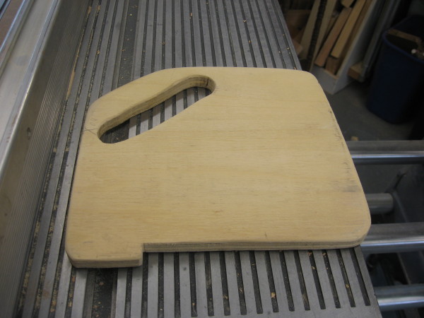

another homemade push block
This is what I use. My dad always said use this instead of your fingers when ripping.......
It also has the advantage of holding the board against the table, and also against the fence.
7 inches high 8 inches long out of 1/2 inch plywood.
for demonstration only crosscut blade in saw.
[ATTACH]25289[/ATTACH]
[ATTACH]25290[/ATTACH]
[ATTACH]25291[/ATTACH]

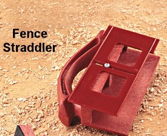

I have always had good luck (for the past 30 years) with the Shopsmith Fence Straddler:
[ATTACH]25292[/ATTACH]
- Fence Straddler.jpg (61.62 KiB) Viewed 4019 times

I agree, but I am worried about the lack of control of the stock away from the fence. How do you control that. That lack of control is why I was looking for something like the Grripers when I found them ....anmius wrote:I have always had good luck (for the past 30 years) with the Shopsmith Fence Straddler:

rjent wrote:I agree, but I am worried about the lack of control of the stock away from the fence. How do you control that. That lack of control is why I was looking for something like the Grripers when I found them ....
Dick
I always cut with the smaller piece being the cut off that isn't being controlled by the fence straddler. That way it just sits there or floats slightly away from the blade. There isn't a fence or other way it can be trapped and flung back at you. It hasn't been a problem for me whether I'm cutting large sheets of plywood or cutting small trim pieces. As long as I'm in control of the wood between the blade and the fence, I feel safe.

OK, gotcha and understand. I will give it a try ...anmius wrote:I always cut with the smaller piece being the cut off that isn't being controlled by the fence straddler. That way it just sits there or floats slightly away from the blade. There isn't a fence or other way it can be trapped and flung back at you. It hasn't been a problem for me whether I'm cutting large sheets of plywood or cutting small trim pieces. As long as I'm in control of the wood between the blade and the fence, I feel safe.
