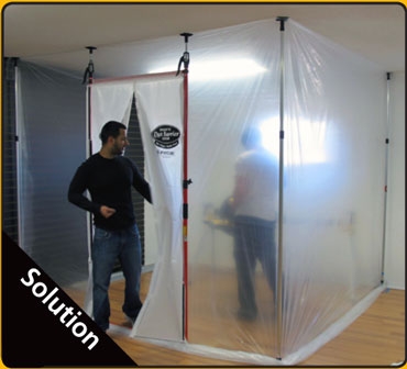

Here is another relatively simple solution for a paint booth. It uses braces or jacks normally used to help hold crown molding and are called by some a "3rd Hand."
[ATTACH]25375[/ATTACH]
paint booth.jpg (60.38 KiB) Viewed 1933 times
