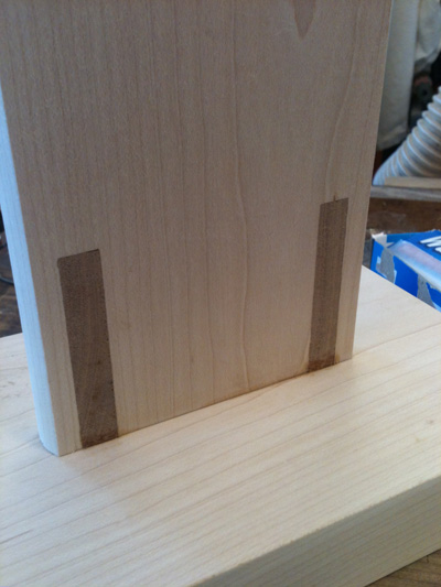

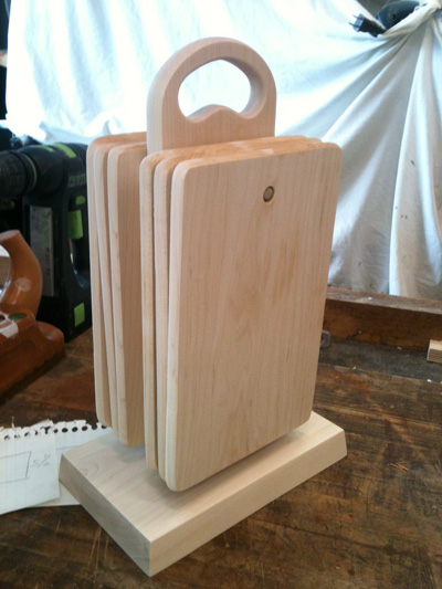

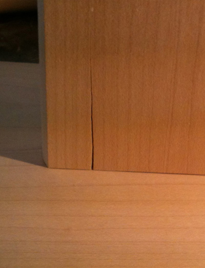

Rather than re-build this rather complicated piece on top:
[ATTACH]25658[/ATTACH]
I decided to repair the split
[ATTACH]25656[/ATTACH]
with four mahogany inlays:
[ATTACH]25657[/ATTACH]
(the darker color at the base of the inlays is water)
After the practice before this final 'fix' and the final version, I have gained the confidence to tackle a piece of Federal period furniture. Now if I can only find the time!:rolleyes:
Forrest

Nice save. Nobody but you (and those who read this thread) will ever know it wasn't part of the original artistic design!
Posts: 3815
algale wrote:Nice save. Nobody but you (and those who read this thread) will ever know it wasn't part of the original artistic design!
Indeed. And I'd bet that 90% would find the "enhanced" design to be even more attractive and desirable. :cool:

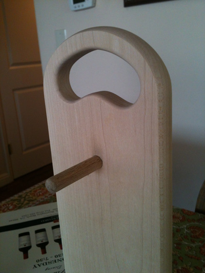

forrestb
Posts: 528
Location: Huntington Beach CA
It's hard maple
Post by forrestb »
Except for the dowel which is white oak.
It's all unfinished (by request) hard maple to be 6 small cutting boards and stand.
[ATTACH]25664[/ATTACH]
Waiting for small rubber feet for the bottom to finish. I have wet everything down and will clean up the raised grain tomorrow.
I have told the prospective owner that if the plain sawn boards start to warp I will re-do them in quarter sawn. Would have liked to do that first but she was in a hurry (her 20 year old set was falling apart) and it was not available locally.
