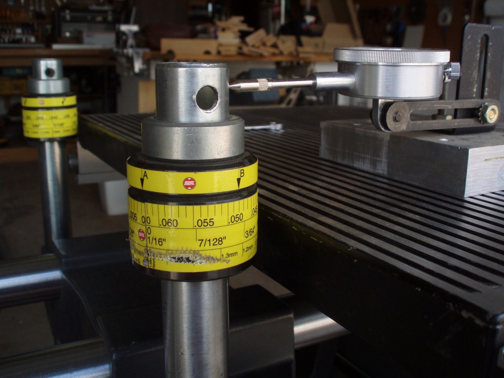

FWIW, if I were to make a jointmatic like jig with one 'leadscrew', I would place the height adjustment force directly over the router axis. That is where the weight and opposing force from the cutter is.
I think we toss this term "slop" around much too freely. Just what is slop and how can it be measured?
I believe that with a standard Shopsmith setup that "slop" is all the direct result of the locks not all being properly secured.
When the five locks are all secure, how does one determine the level of "slop" that remains.
Let me go on record as saying I feel that I have no slop. If I am wrong, tell me how to determine that myself.
FLEX is a different discussion and most of that is eliminated by using the 5' tubes or some version of them to tie the tables together providing a four point (or more) stance.

Yes. If you apply downward pressure at the edge of the main table (especially the right edge) you can alter table tilt. The table tilt lock is not strong enough to resist that pressure (distance from the trunnion functions as a lever).
If I am doing a job where I can not accept unwanted/unexpected movement of the table, I support the edge with what amounts to an adjustable third table leg.

Agreed, I tend to use the word often, but it is not necessarily a bad thing. In the context of this thread, clearance is a more accurate term. Things which move(main table mounting posts) must have clearance or they would be jammed in the carriage bores. That small clearance gets reflected at the table as a much larger range of motion.
Also for this thread(pseudo joint matic) where the table is intended to provide vertical adjustment/movement, this clearance and the table positional variation as a result will compromise very fine tuning.
I assume that the vertical repositioning need be done while the cutter is 'cutting' and for that the lock is 'off'.
As clarification again, I only question the ability to adjust vertically repeatably to an accuracy of one thousandth of an inch. For all intents it will work probably satisfactorily for most applications, but not likely as accurate as a jointmatic.
How much "slop" is typical in a Mark V setup? I don't know! But, just for kicks, I would like to know and thought this might be a start at finding out.
I have the dial gauge setting on an extension table where it can measure any movement with respect to pseudo main table legs installed in the carriage. Likewise, if the carriage moves with respect to the extension table, that too will be reflected on the dial indicator.
[ATTACH]25655[/ATTACH]
