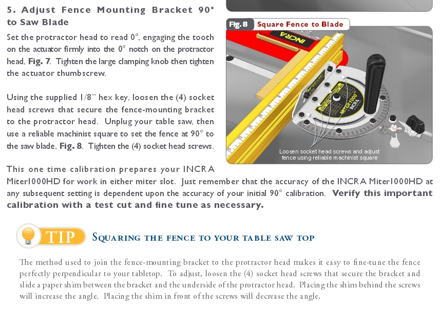

Aha! Two part 'head'.
[ATTACH]25646[/ATTACH]
incra zeroing.jpg (283.99 KiB) Viewed 1780 times
JPG40504 wrote:Aha! Two part 'head'.
I squared to the table as recommended but I did not square to the saw blade. I squared to the miter track rather than to the blade.

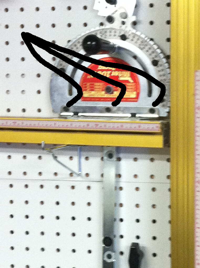

Ben, On the Incra, if you loosen the four screws that secure the "protractor" to the miter bar, does it not adjust (for fine tuning).:confused: Refer to post #13 this thread.

dusty wrote:Ben, On the Incra, if you loosen the four screws that secure the "protractor" to the miter bar, does it not adjust (for fine tuning).:confused: Refer to post #13 this thread.
First I apologize for the picture!! Camera phone zoomed in, with an unsteady hand from too far away, but can't get closer for a few days!!:mad:
[ATTACH]25651[/ATTACH]
If you mean those three bolts, yes, I could adjust using those and it is what is in the manual
However since the gauge will, for the foreseeable future be used exclusively with the sled, I was told to just adjust the swing of the fence. Quicker, easier,and all that was necessary or so I was told . I don't move the fence laterally. Ordered the correct tape, so when things get sorted out will install and zero it.
Unfortunately, other peoples mega errors have thoroughly screwed up my schedule so I am not in a mood to spend more than one go round trying to adjust the miter gauge. If the quick and dirty fix doesn't work then I will have to live with the results for at least a month (probably closer to 3 :mad: :mad: :mad: )
But, yes you are correct in how the gauge should be properly adjusted.
Be well,
Ben
So this is what precipitated that apology.
I agree that your shimming will alter/correct the angle maybe easier than the 'correct' way. More than one way to achieve the same result.:cool:
Nothing you posted you posted to this thread is inaccurate, but does deviate from the 'official' method.
