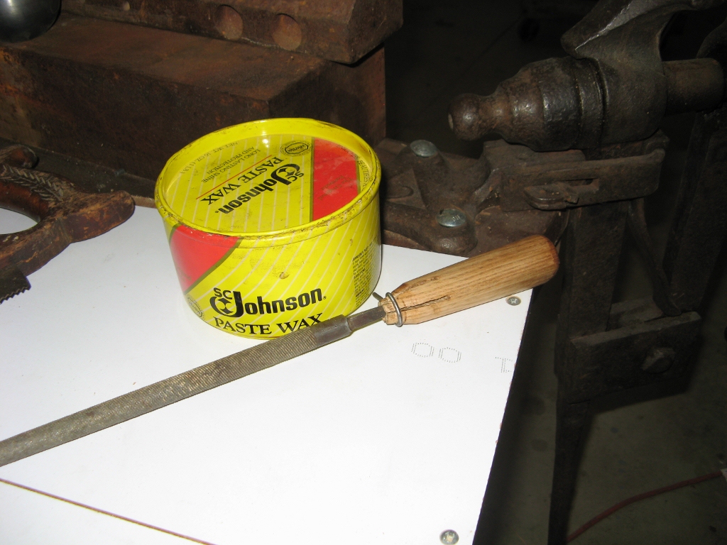

My version fo a file handle
For what it's worth this is my version of a file handle.Gene Howe wrote:
What do you all think? Any ideas? Am I on the right track or should I just buy handles?

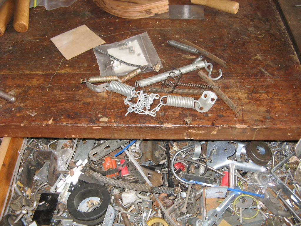

First thing select a spring and cut a coil or two off the spring.
[ATTACH]25692[/ATTACH]

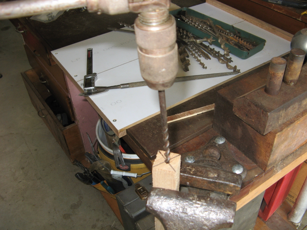

Search the scrap bin for a piece that will make an appropriate handle. Mark the center of one end. Find a drill bit about the diamiter halfway up the file tang. Drill a hole down the center of the stock.
[ATTACH]25693[/ATTACH]

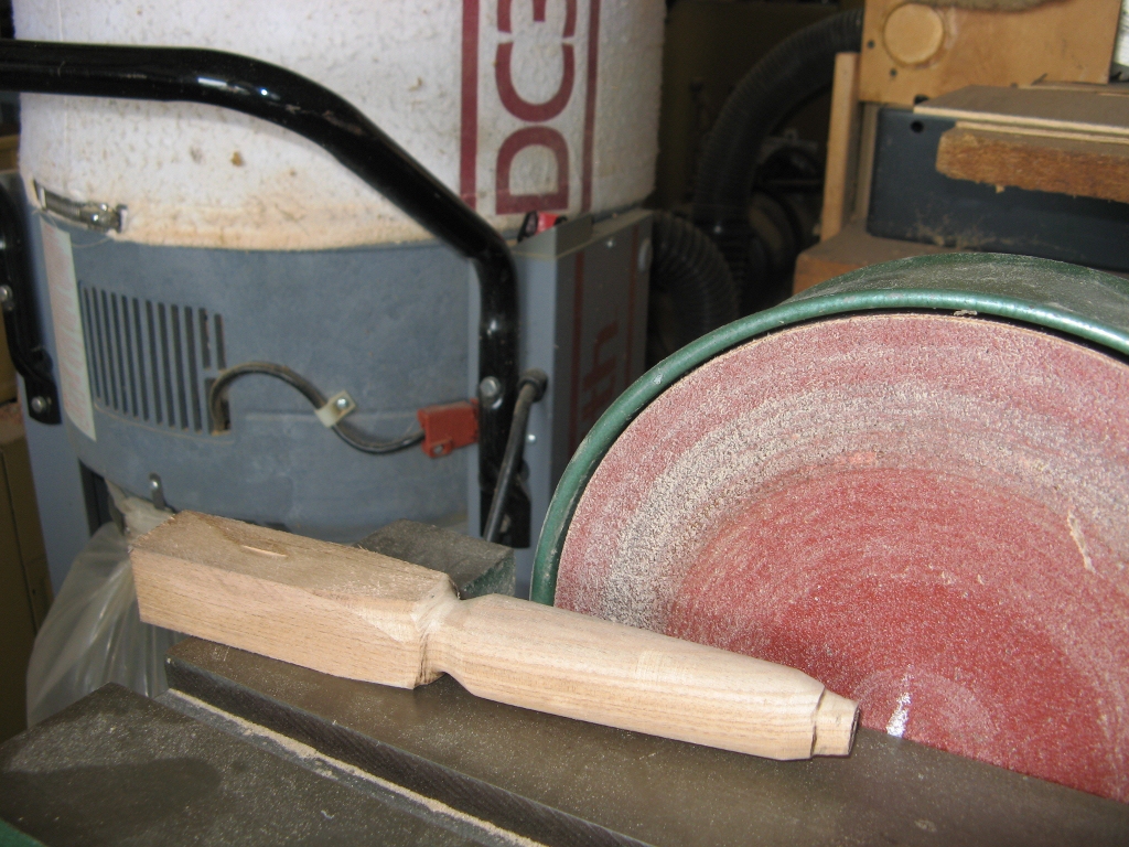

Next use the SS disk sander to shape the handle to desired shape.
[ATTACH]25694[/ATTACH]

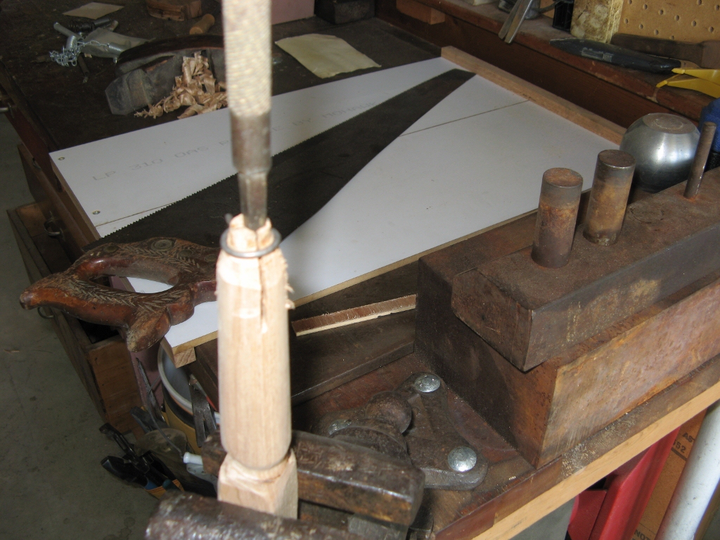

Cut a cross kif the depth of the drilled hole and place the spring coils on the end of the handle.[ATTACH]25695[/ATTACH]
Remove the waist finish or not and commence fileing in comfort.
[ATTACH]25696[/ATTACH]
