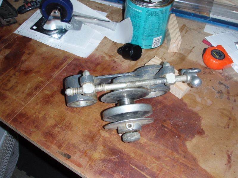

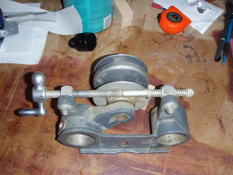

I dont understand the "dial" numbering. No #s on it and I think it is broke anyway after examining today and JPGs warning on another thread.
- P8040125 (800x600).jpg (437.31 KiB) Viewed 1916 times
- P8040123 (800x600).jpg (429.11 KiB) Viewed 1913 times

Not sure why you think it broke. It looks good to me unless I'm missing something. I need to go out and look at mine to be sure. I believe the threads only engage on the one side. As long as the center part of the pully system slides back and forth on the shaft and the ear is not broken off you should be good to go. I'll double check tonight.rbursek wrote:I dont understand the "dial" numbering. No #s on it and I think it is broke anyway after examining today and JPGs warning on another thread.

Pulley slides smoothly, still trying to figure out what the ears are!!

The ears are what the bolts go through with the nuts on the other end. I think you are good to go, just slip the whole thing on to the tubes and attach it to the unit with a bolt. There is a lot of adjustments that can be made to the shives on the pulleys depending on the width of the belts. You just don't want the bottom of the belts to bottom out on the pulley shaft so you need to adjust the gap between the sides of the pulleys properly.rbursek wrote:Pulley slides smoothly, still trying to figure out what the ears are!!

Got it all now Fred thanks, I see how it works now, nothing is broken.
