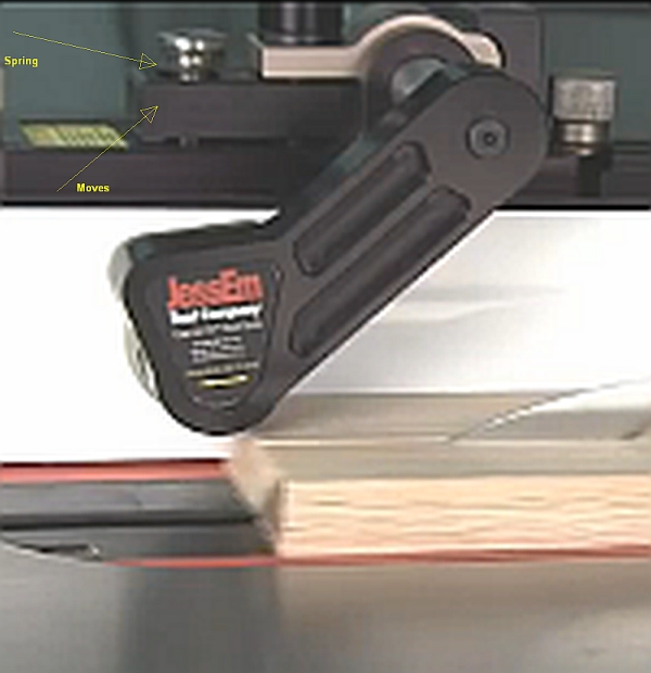

dusty wrote:They look like feather boards with wheel bearings with rubber tires. Are they spring loaded?
They are spring loaded. Notice the upper black portion moving upward when the workpiece is slid under the rollers.
[ATTACH]25919[/ATTACH]
Besides he said so. Board under spring pressure.
- jessem spring.jpg (151.34 KiB) Viewed 8345 times
Looking more closely, it appears these are designed to attach to a t-track mounted directly to the table saw's rip fence.
If I were mounting this to a 510/520 with its built-in proprietary size t-track, I would try substituting the Shopsmith t-nuts and mount the hold downs directly to t-track built into the 510/520 fence; otherwise I would use the Shopsmith t-nuts to mount a board to the fence and then mount the Jessum t-track to the board.
I would not drill my 510/520 fence.
If you watch the table saw video all the way through, they show it in use with a typical saw guard.lightnin wrote:It looks like it interferes with the use of saw guards.
One thing it would definitely interfere with is the fence-stradler push guide that comes with the 510/520, which I occasionally use.

I agree. It looks like it would be a bit awkward to push the end of the stock past the blade with those rollers in place.rcplaneguy wrote:Kinda funny that their videos keep cutting away as the push stick is about to have an issue wih the rollers. In the way.
Bill
Mark V 520 50th Anniversary Edition, Planer, Jointer, Bandsaw
mountainbreeze wrote:I agree. It looks like it would be a bit awkward to push the end of the stock past the blade with those rollers in place.
The rollers can be relocated or even moved completely out of the way. The only time that see them as "in the way" might be well ripping narrow stock. If I found myself in that situation, I would stop the saw and remove the work piece and then finish the rip from the other end.
I do that a lot, even with SS featherboards when working on small stock. Doll furniture and toys provide many opportunities like that.
