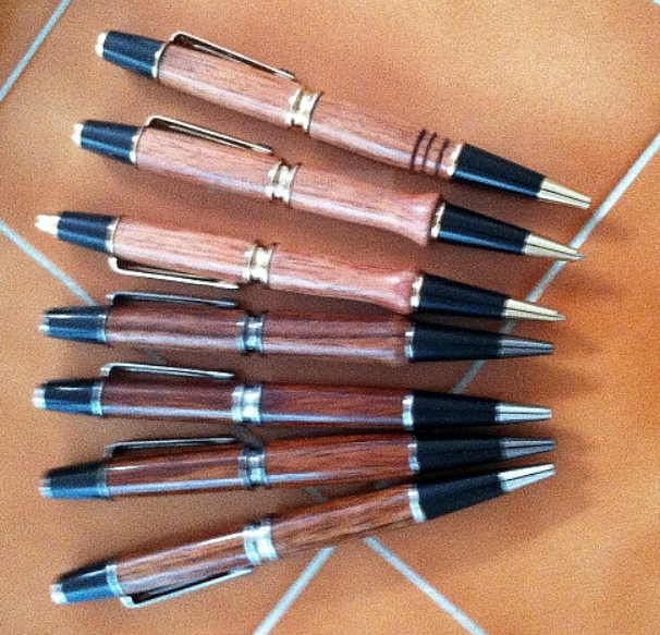

My first Project on my Mark 5
tnvol wrote:Nice work! I may try my hand at it soon. About how much do you need to invest to get started, with mandrel, finishes, etc. ?
Finishes are purely a matter of choice. Wanting to keep it simple (KISS) I just used Super Glue and some fine sanding pads.
I've only made 7 pens, so no expert in this field. Here's a Pix:
[ATTACH]26112[/ATTACH]
first pens.PNG (1.03 MiB) Viewed 1903 times
