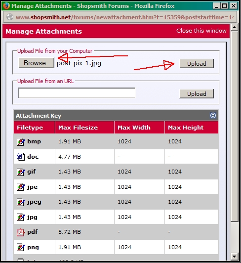

I assume you started here.
[ATTACH]26599[/ATTACH]
And likely first browsed, then uploaded.
[ATTACH]26600[/ATTACH]
But did you then browse/upload again?
[ATTACH]26601[/ATTACH]
You can attach up to five/post,
- post pix 1.jpg (163.87 KiB) Viewed 4151 times
- post pix 2.jpg (128.43 KiB) Viewed 4152 times
- post pix 3.jpg (134.8 KiB) Viewed 4152 times

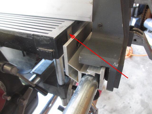

Have had the 4 screws all the way out. There is just no more adjustment to the right available. Front screws against the right and rear screws against the left. Don't know if you can see by this. Front is to the left.
[ATTACH]26602[/ATTACH]
- image.jpg (65.22 KiB) Viewed 4153 times

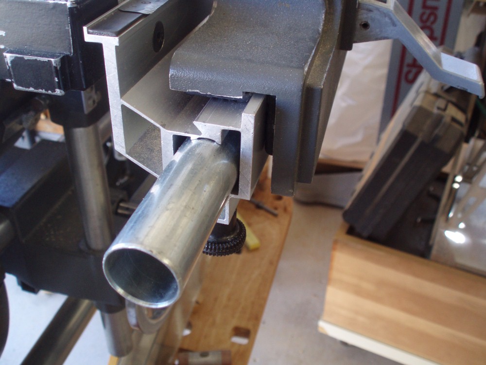

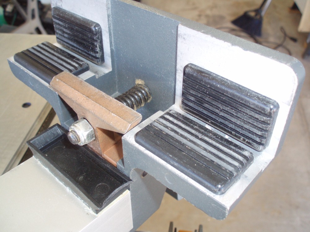

[ATTACH]26604[/ATTACH]
[ATTACH]26605[/ATTACH]
[ATTACH]26606[/ATTACH]
The pads that separate the fence rails from the underside of the head on the rip fence all need to be approximately the same thickness. Mine are 3/16" thick with very little deviation from pad to pad.
When the rip fence is mounted to the table, the gap between the fence and rails (images 1 & 2) is 3/16" (established by the thickness of the pads. The pads on both sides of the rip fence should be hard against the front edge of the front rail.
- 520 Rip Fence 005 (Custom).jpg (145.79 KiB) Viewed 4148 times
- 520 Rip Fence 006 (Custom).jpg (134.07 KiB) Viewed 4147 times
- 520 Rip Fence 008 (Custom).jpg (175.15 KiB) Viewed 4148 times

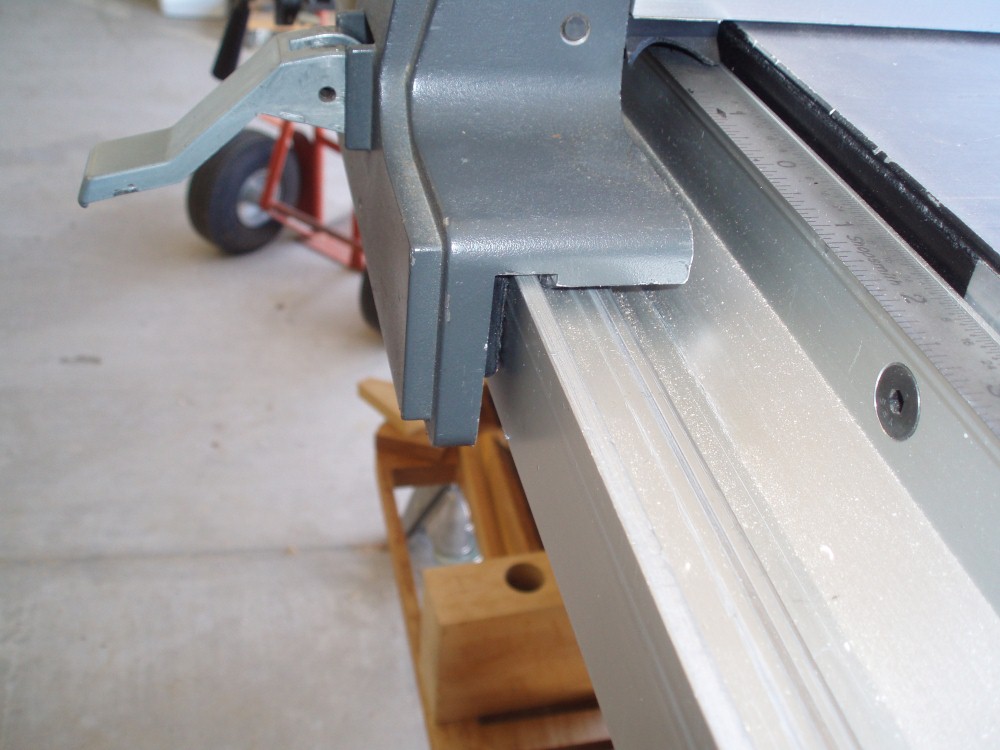

Thank you Dusty. Everything there looks square. 3/16" slide blocks both sides. 3/16" gap between rail & fence. 3/8" between table and rail all the way across. There is a gap when the fence isn't locked between the rail and nylon blocks.
For some reason it won't let me upload more than one pic at a time. Just replaces the pic already there instead of adding another.
[ATTACH]26608[/ATTACH]
- image.jpg (86.67 KiB) Viewed 4144 times
