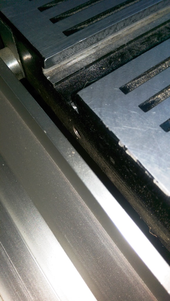

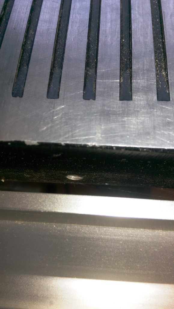

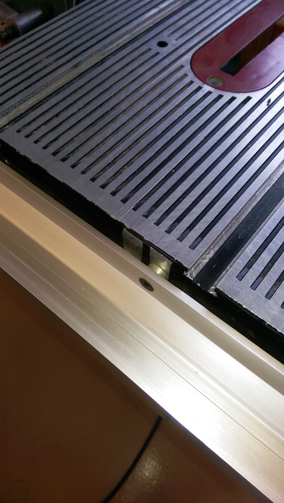

Now lets add some more intrigue to this. My 1984 510 new from SS had the new style rails with the studs (through holes in the right place). The 520 rails just bolted up. They were pre magnetic rule. I bought the magnetic rule upgrade and they bolted right up.
Now it gets interesting. That 1984 table has two 1/4-20 threaded holes in the front and back edge of the table. The old 510 rails??? If that is so then there is a bigger difference than just the center hole. This table also has a mounting boss cast on the table edge off set from the 520 rail center bolt both front and back. Consistent with what JPG has been saying. That boss does not have a hole in it. Also the two tapped holes do not have a boss. See the pictures.
I also have two main tables bought on eBay (vintage unknown) that have the smooth top between the miter slots that have neither the second center boss or the tapped holes.
- IMAG0405.jpg (223.51 KiB) Viewed 6532 times
- IMAG0407.jpg (191.4 KiB) Viewed 6532 times
- IMAG0408.jpg (233.41 KiB) Viewed 6532 times
