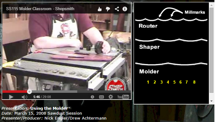

More info on Router .vs. Shaper .vs. Molder
Post by bffulgham »
The Shopsmith Molding catalog page (from an earlier post) has a link to the SS115 Molder Classroom session. About 4 minutes into the video, Nick gives his viewpoint on Router .vs. Shaper .vs. Molder mill-marks. There's also a 'visual aid' in the chalkboard window for reference:
[ATTACH]26625[/ATTACH]
One can minimize the effects of mill-marks by using a slower rate of feed. But, with too slow of a rate of feed, you get burn marks.
The only way to eliminate mill marks is to sand or scrape (or use a molding plane to start with).
As far as kick-back goes, the larger the diameter of the cutter, the longer the lever for throwing the work-piece. The longer the lever, the more force developed. BUT, the longest lever in this scenario has the slowest speed. The smaller diameter cutters make up for some of the lever length by increased speed. While we could spend hours discussing which is worse, the bottom line is all three of these methods can result in kick-back, so be careful with all of them.
