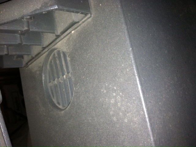

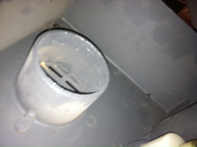

There is a dust collector hole in the bottom of the saw, beneath the front. Using a dust collector will certainly cut down on an accumulation of sawdust.

charlese wrote:There is a dust collector hole in the bottom of the saw, beneath the front. Using a dust collector will certainly cut down on an accumulation of sawdust.
I don't see one. Would love to know where it is.

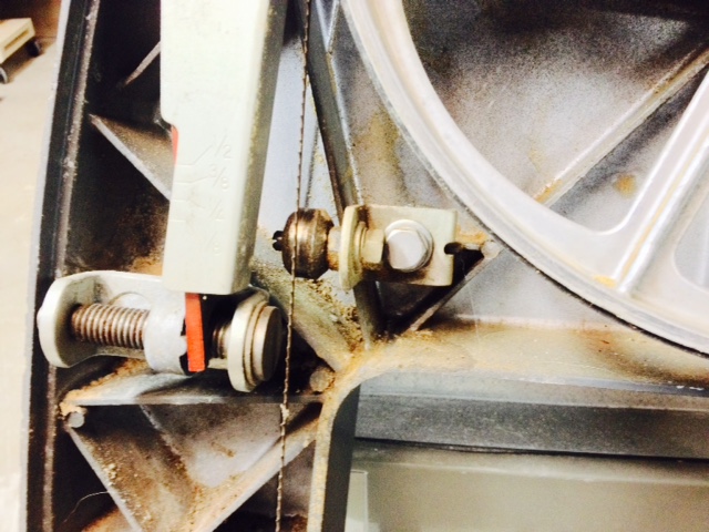

So, I finally got to taking a closer look at the band saw. This was a freebie the owner tossed in when I bought the scrolll saw, so even if it is a basket case it is no big deal.
I opened it up to find a massive mouse house. But no mouse. Brushed that out. More thorough cleaning to come.
Surprisingly the tires are in good condition and the wheels spin fine by hand (haven't powered it up yet).
But I noticed there are some non-standard parts.
First, the auto-track double bearing has been replaced with a single bearing:[EDIT: After checking my manual, I believe this was standard equipment on older band saws.]
[ATTACH]26682[/ATTACH]
Looks like I will be ordering those bearings from Shopsmith.

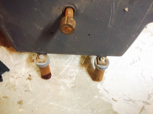

Second, the leg tubes look odd.
[ATTACH]26683[/ATTACH]
Are these the factory special band saw eccentric legs (with stop collars added)? [EDIT: Yes, they are!] Or are they a home made version? If they clean up in Evaporust and work, I'll keep them.

algale wrote:I don't see one. Would love to know where it is.
If you had one, you wouldn't miss seeing it. I got my scroll saw from a friend who bought it from another. The port is directly below the saw blade. Maybe the dust port was added aftermarket.
I took a couple snapshots with my phone, but they were too big for the forum. I'll snap a couple more tomorrow and make them smaller.
The gray version has one but if memory serves me the teal version did away with that feature. I don't own one to look at but I seem to recall noticing that when I looked at one.

Here's the photos - I made them smaller and tipped them sideways.
This is the top view - just below the blade

This is the bottom view where the DC hose goes.

I think ED is correct that those chips didn't come from the scroll saw.

charlese wrote:Here's the photos - I made them smaller and tipped them sideways.

Hmmm. That definitely isn't something my teal scroll saw has. Is yours the teal model or the gray model?
