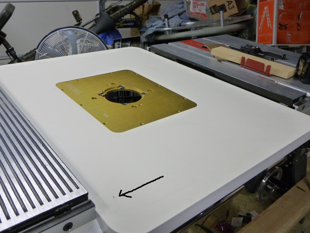

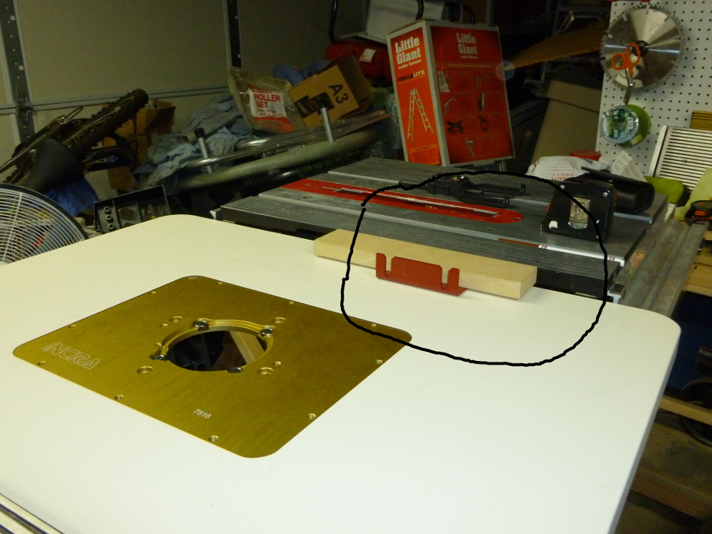

The first two pictures are of the INCRA table set in between the main and aux tables and yes I know its on the wrong side,:rolleyes: but this was just to test for fitment ideas since the table is 21" wide ergo will not fit without trimming.
[ATTACH]26672[/ATTACH]
The first picture shows the table setting on the bars with a bracket provided from INCRA for attachment and a piece of 3/4" MDF to sho the nearly perfect height match,
[ATTACH]26673[/ATTACH]
The arrow points to a small do which is where the table needs to be trimmed to fit within the 20" gap

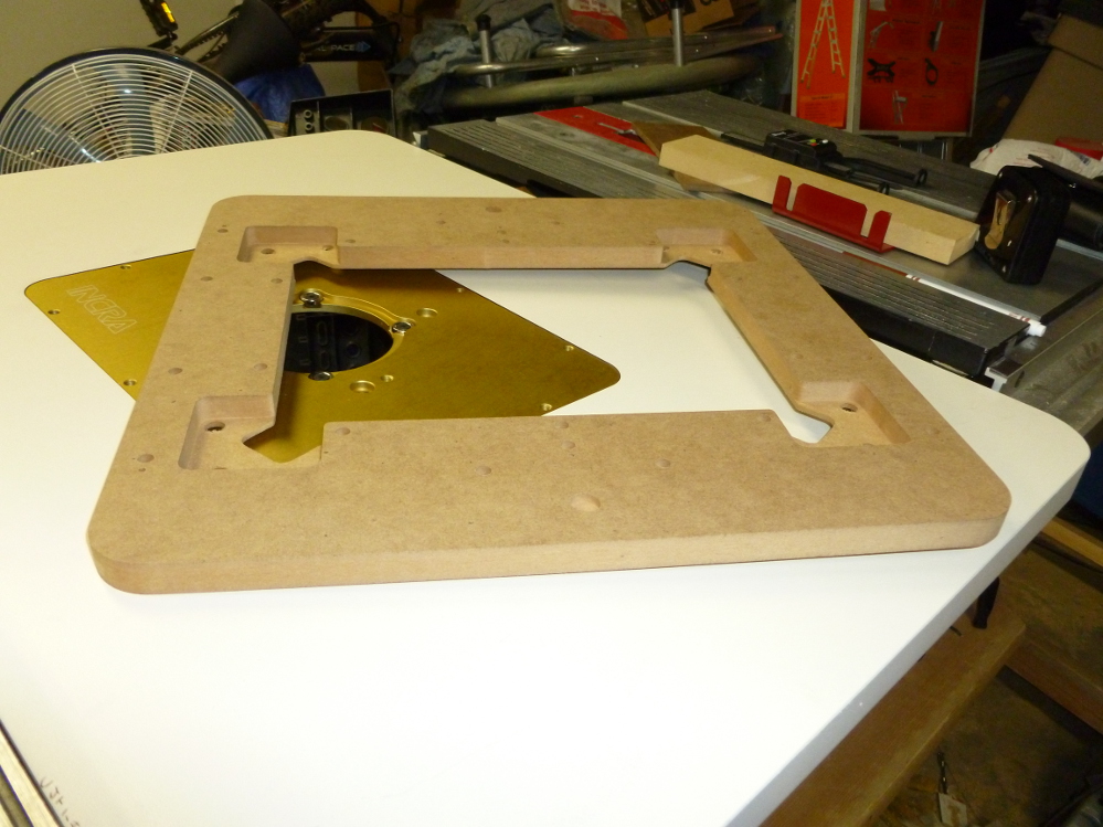

This picture is of a piece that can be secured to the bottom of a board which has already been cut to receive a router plate. This is used to level a router plate. It comes with a bunch of leveler screws but it is difficult to see the holes where they go. I had originally intended to try to attach this to the bottom of a SS main table (that project is no longer), I still think this would be a viable alternative, but 510 tables are too expensive to keep mangling. :(
