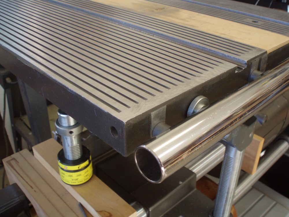

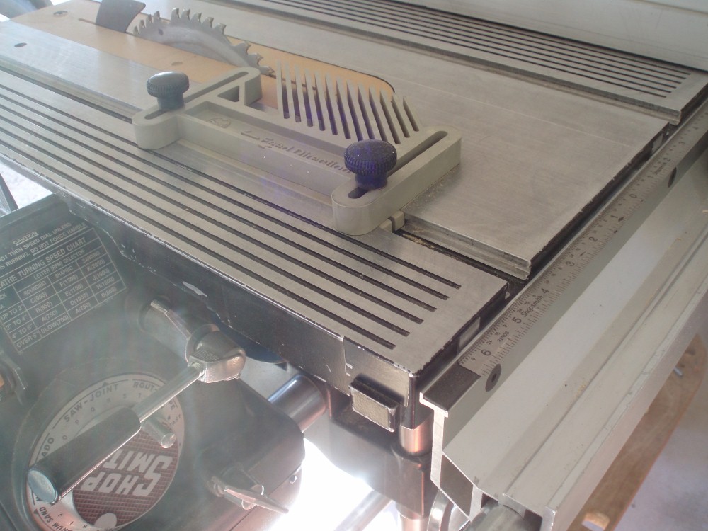

Can someone please tell me how I know which 510 table I have? How do you know? Is one advantageous over the other?
Thanks
Thanks
SS Mark V (1983 from Grandfather) upgraded to a 510, pieces to make a 500 mini, SS bandsaw, belt sander, broken scroll saw, and strip sander, Jet VS Mini Lathe, and tons of Lee Valley and vintage Stanley planes. Woodcraft slow speed grinder and a German made Tormek wannabe. Ridgid TS 3650 Table Saw, General 80-075LM Jointer.
ibskot wrote:Can someone please tell me how I know which 510 table I have? How do you know? Is one advantageous over the other?
Thanks
Functionally there is not much difference (if any).
These are the two versions that I know about.
[ATTACH]26785[/ATTACH]
[ATTACH]26786[/ATTACH]
The ribbing on the work surface is the major visual difference. The one with less ribbing is the later model. The one that is ribbed all the way across is my preferred model.
The small rectangular protrusion at the corner has no functional value that I am aware (except maybe during the manufacturing process). I dislike it because it prevents the tables from coming together like the older tables do. Strictly personal preference.
Disregard the rails. The round rail can be used on either table. The extruded rail can be used on either table but the extruded rail makes it a 520 configuration (not what you asked about).
Hope this helps.
