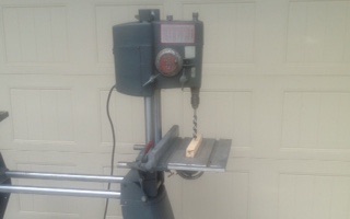

Here is a better picture of a shorty in drill press mode
[ATTACH]26927[/ATTACH]
The distance for the drill press is shorten as the shorty is shorten. But you can remove the table and have all the room to the floor to use. Go for it cut 19 let us know how it turns out. :eek:

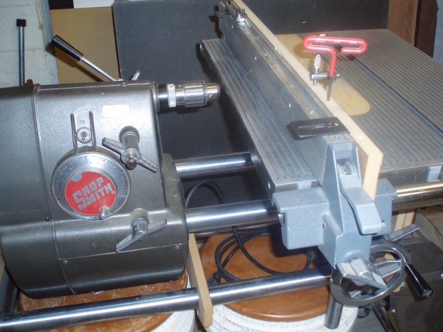

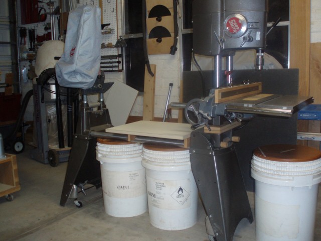

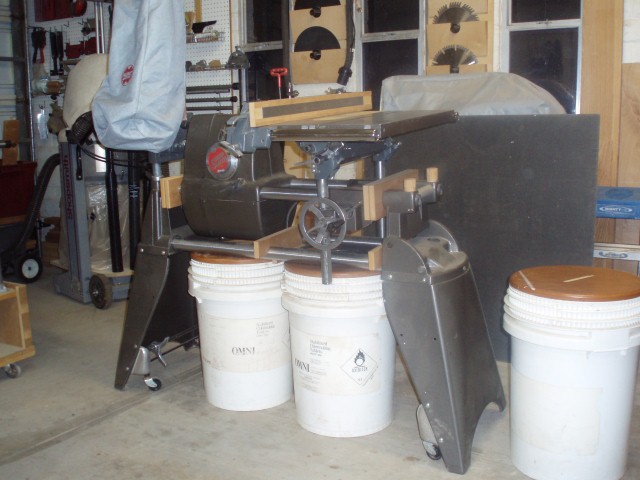

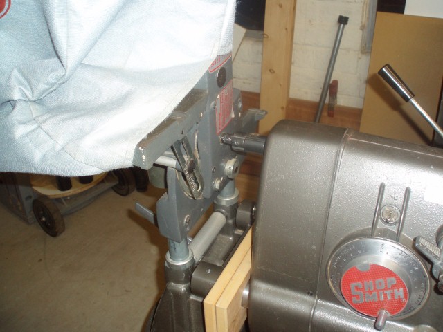

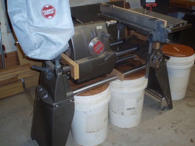

A Shorty (Reduced by 16")
Here are a couple pictures depicting the Shorty in my shop. It still possesses all of the capabilities of a full sized Mark V with a couple limitations in capacity.
Obviously, lathe capacity and drill press capacity are reduced.
If I had the required floor space, I would not have created the Shorty but the Shorty allows me to have both it and the full sized Mark V in my shop without me tripping over something.
[ATTACH]26937[/ATTACH] [ATTACH]26938[/ATTACH]
[ATTACH]26939[/ATTACH] [ATTACH]26940[/ATTACH]
[ATTACH]26941[/ATTACH]
The table, in the drill press mode, is too low to work at while standing. Sitting on my make shift stool is about right. Maximum drill capacity is 8 3/4" less the length of the bit being used. This has worked for MOST of my drilling needs. It is definitely a limitation of the Shorty.
