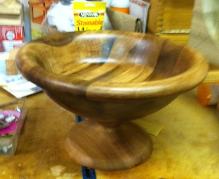

inside of bowl (2).JPG (54.34 KiB) Viewed 2179 times

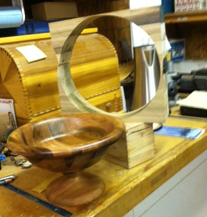

- I hope the three photos will show here. They show the finish as well as the remains of the 12" x 12" blank after the round bowl was sawn out.
bowl & remainder of bowl blank (2).JPG (68.21 KiB) Viewed 2179 times

Nice piece! The pedestal base and undercut rim take it from ordinary to extraordinary. I'm not going to show those photos to my wife until I have time to make a replica!
Now that photos are working again, I can see the bowl-blank remains. How thick was the blank? At the angle seen in the photo, the bowl looks about twice as thick as the blank. :confused:

Thanks, Dennis! The blank was 12"x 12"x 4" thick.
