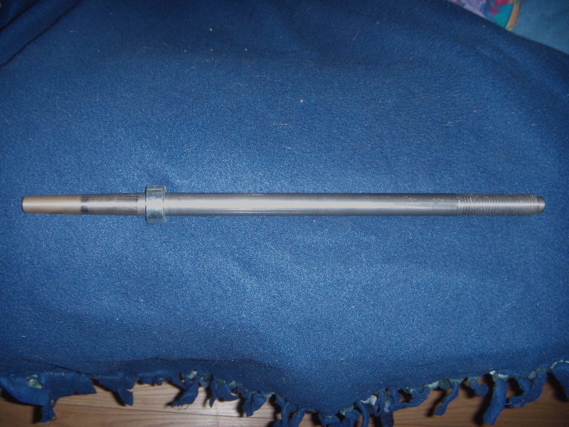

maxwell wrote: "...The Beall 3-On Mandrel Buffing System is a 3/4 inch steel mandrel with a #2 Morse taper-drive on one end and a cupped end on the other to accept a cone center. I bought one from WoodCraft (and can still return it) to see if I (or some of you) can figure how to SAFELY drive the thing on our SSmiths.
The ends are too large (5/8 inch) to put into the drill chuck, or I woulda already been polishing my fool head off. After chatting with SS tech support (very helpful in the past) and the folks at Beall, I understand there are no adapters available nor in R&D (no big surprise there...) I have not the tools to turn a half inch tenon on the morse taper end, but I could take it to a local machine shop to do that (pricey, tho)...."

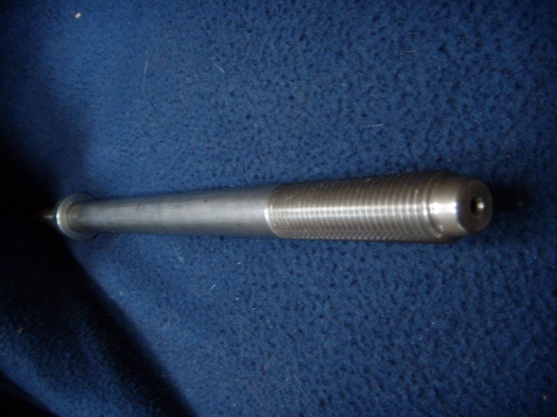

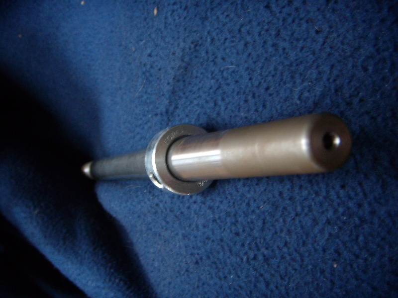

ldh asked for photos, and here they are-obviously a photographer I ain't...
Morse taper end.JPG (255.21 KiB) Viewed 4398 times
Threaded end.JPG (268.69 KiB) Viewed 4392 times

Well, I hope the main pic is OK with y'all. The end shots (esp. morse taper - almost poked me in the eye when I opened it!) certainly leave something to be desired for providing clarity. As you could see from the main shot, that end is tapered, really...

Thanks for the pics, now I know what the thing looks like. I would like to know the diameter of the shaft and it's length. I think I can construct one with OTC parts. I will get what I need on order this week, should be fun.
