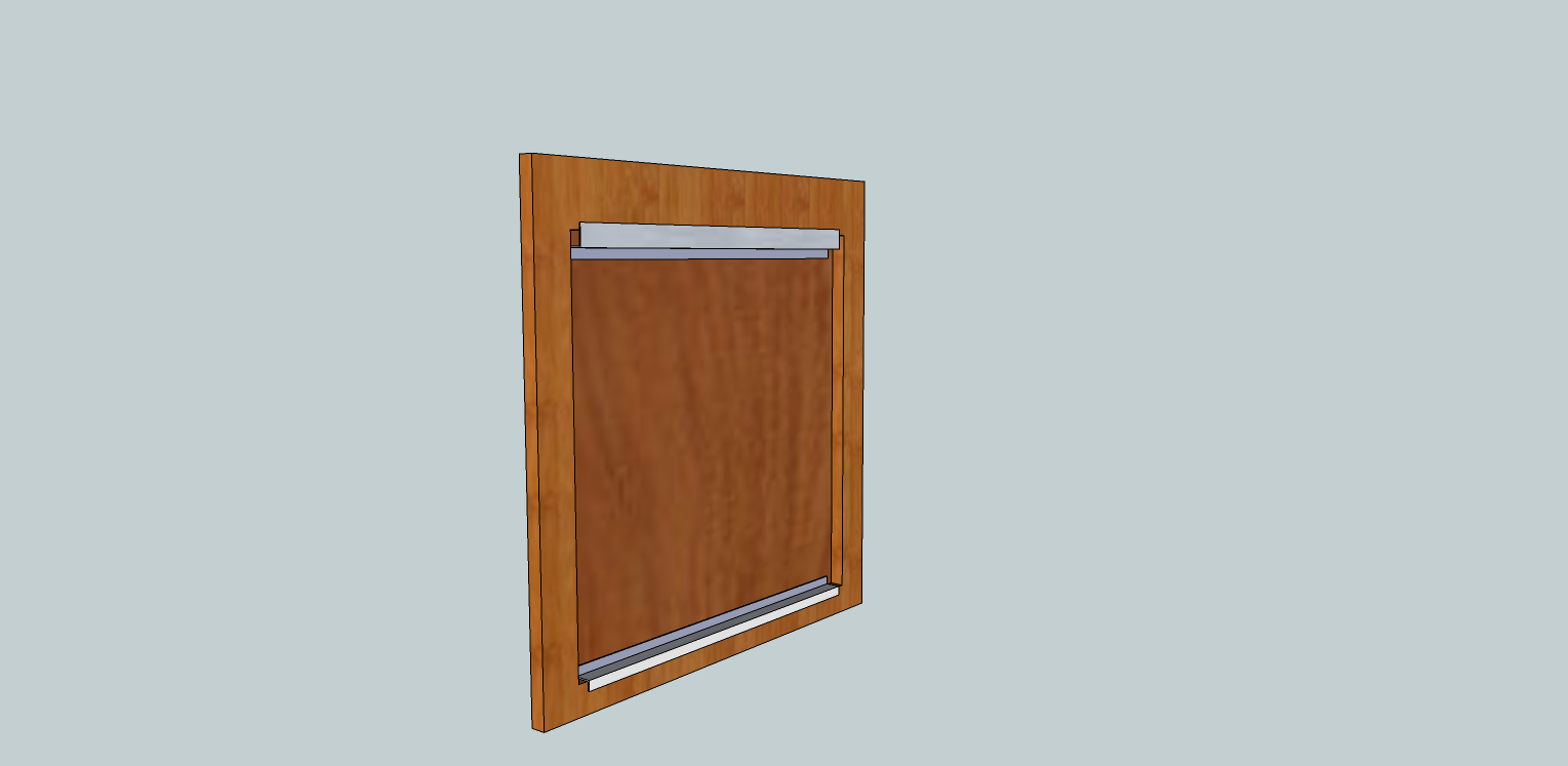

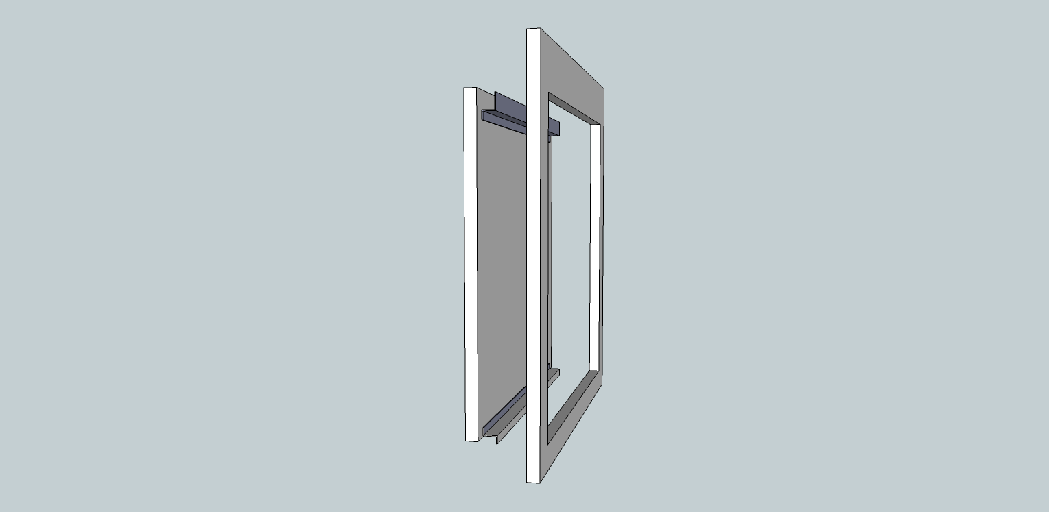

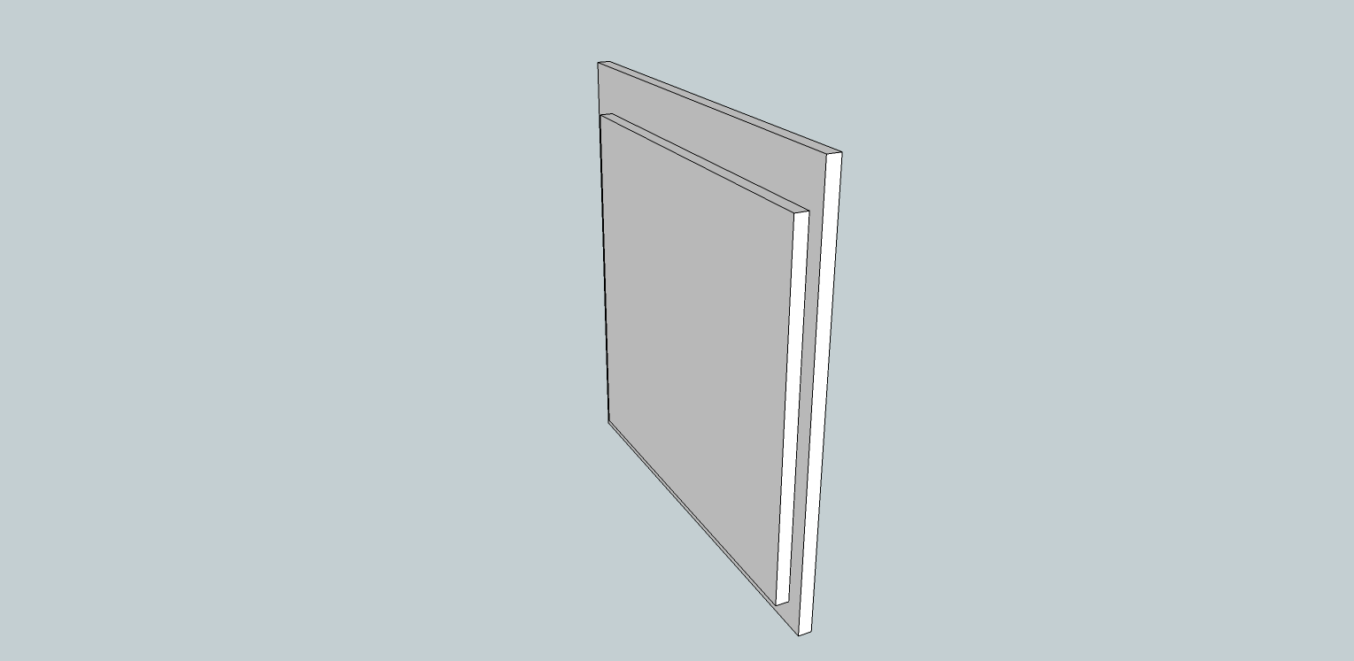

I do believe I have a viable solution to 'my perceived problems' with the current cabinet doors in the RV. This potential solution comes as a combined result of comments made in response to my request. I thank you all.
The solution (pictured later) is a version of the french cleat (sorta). At least my vision of this solution was prompted by the french cleat recommendation.
All I have to do now is find a way to bend light weight sheet metal to create the required parts. If I had access to a sheet metal break it would be a snap.

That looks like it will work. Why sheet metal versus wood? Weight?

algale wrote:That looks like it will work. Why sheet metal versus wood? Weight?
I don't know and wood might be a better solution because the cleats could be glued to the doors. The sheet metal approach would necessitate screws to say nothing of the "bending the sheet metal" issue. The jury is still out.
I'm going to put together a door from cut offs to demo/test the first version of the solution.

If you made the metal parts from a narrower 'strip', you could 'form' the 'z' 'cleats' in a vise. Two on each end(top and bottom) should do the trick.*
Does not eliminate the screws though.
* actually three would suffice(two on top or bottom at the sides, one at the middle of the other end). I think two at the bottom would be better.
