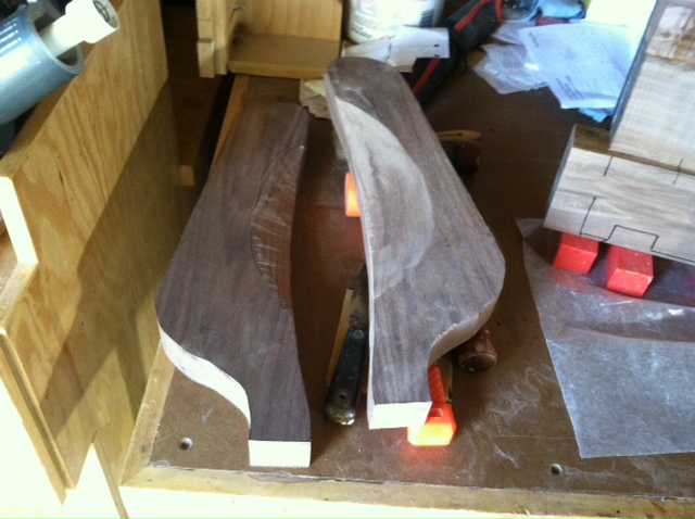

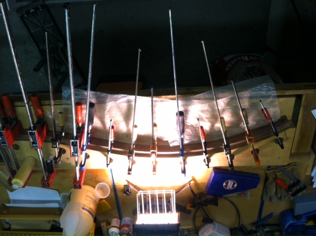

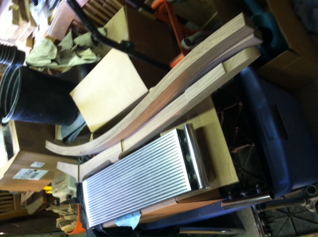

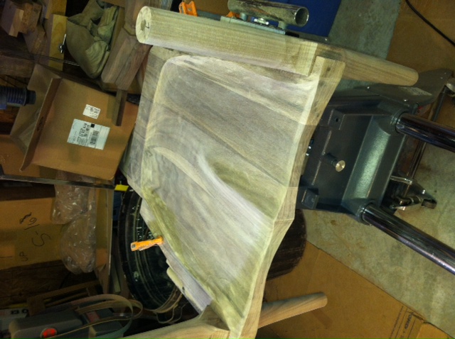

After making some progress on the rocker, it's now time to post some photos of the progress. Oh Yeah! Still a couple of months to go and lots of rasping, riffling and sanding to do. Wish I could say it is nearing the end, but there's much to do.
Like the instruction book said - The plans show full scale parts, but adjustments will be necessary.
Here's some pics:

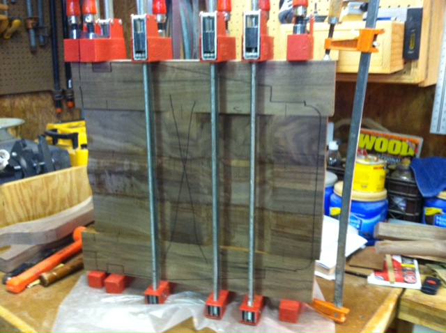

gluing seat.JPG (137.14 KiB) Viewed 2984 times

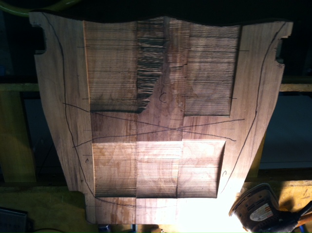

seat bandsawn.JPG (100.4 KiB) Viewed 2984 times

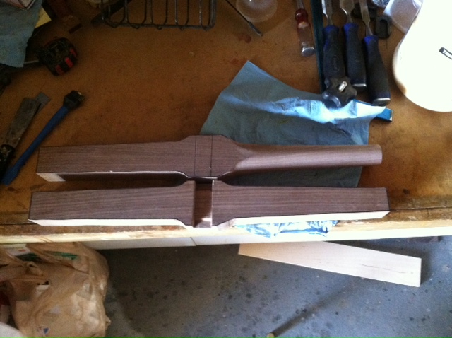

back leg and rocker.JPG (120.58 KiB) Viewed 2984 times

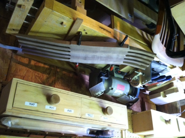

arms with bandsawn shape.JPG (118.32 KiB) Viewed 2984 times

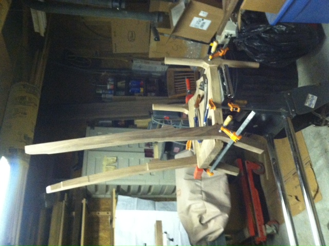

laminating rocker.JPG (112.42 KiB) Viewed 2984 times

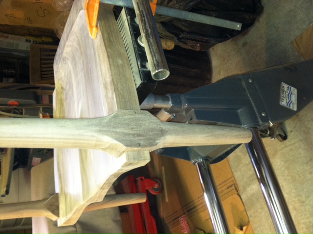

both sides of joint - front leg.JPG (120.16 KiB) Viewed 2983 times
rear leg joint.JPG (112.74 KiB) Viewed 2983 times
dry fitting legs to seat.JPG (123.64 KiB) Viewed 2983 times
front legs glued.JPG (118.76 KiB) Viewed 2983 times

Re: My Next Project
rjent wrote:That is going to be fabulous! Nice taper turnings .... :cool: (I assume that is how you did it LOL)
Hope it's going to look good! Yes, after making the joints in the front legs, had to turn the top and bottom.

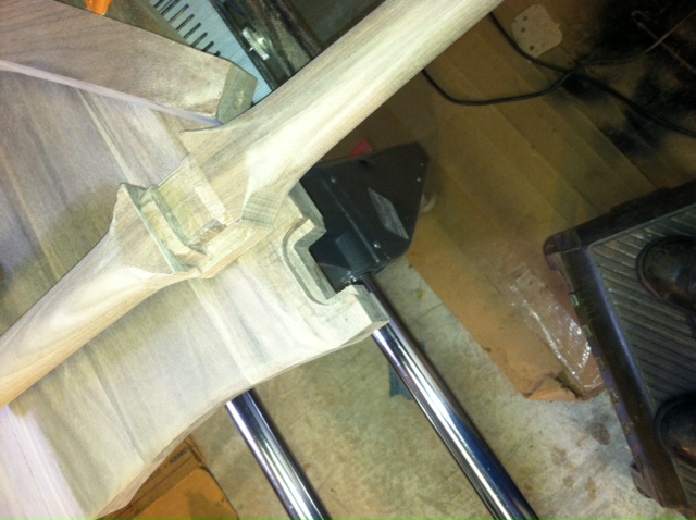

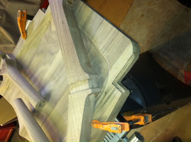

This leg has the most difficult joint I've ever made - a center flat to mate with the cut out in the chair, plus a rounded raised rabbet to meet with the rabbet in the chair and also cut to fit the top and bottom of the seat with no gap. - - All to be at a depth that will allow some rounding of the outside of the joint and shallow enough to allow inserting two screws through the joint. This took me two days per leg.
Side Note: And of all things, had to throw away one leg after hitting an embedded nail. It was bent and evidently burned. This caused to wood above and below the nail to be charred. looked just like the next morning of a yule log fire, all grown over by the tree. Completely hidden! :eek:

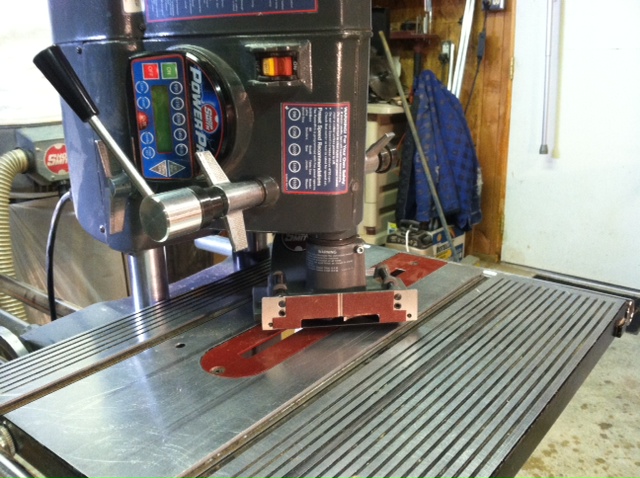

The back legs cutout in the seat are tapered at 5 degrees. Also the rabbets are tapered to 5 Deg. The plans called for buying a special set of router bits tapered at 95 and 85 degrees. Instead I used the Shopsmith tilting table and chisel work to shape (slope) the rabbets.
