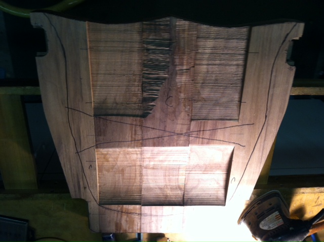

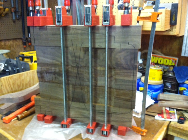

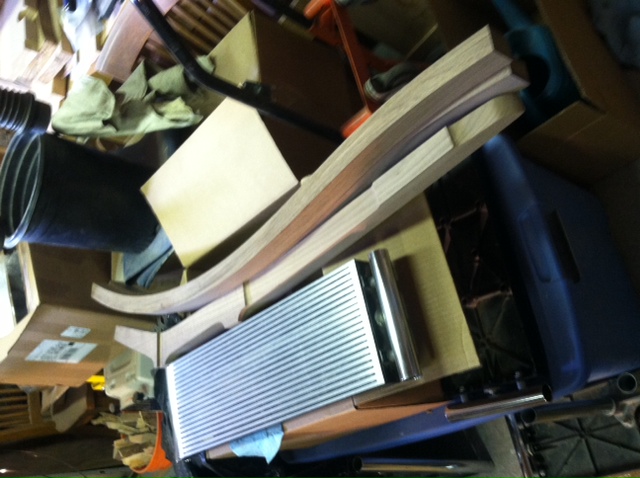

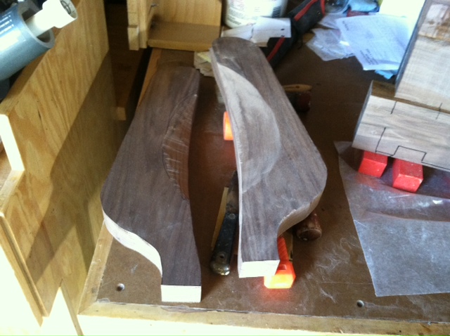

After making some progress on the rocker, it's now time to post some photos of the progress. Oh Yeah! Still a couple of months to go and lots of rasping, riffling and sanding to do. Wish I could say it is nearing the end, but there's much to do.
Like the instruction book said - The plans show full scale parts, but adjustments will be necessary.
Here's some pics:
gluing seat.JPG (137.14 KiB) Viewed 2993 times
seat bandsawn.JPG (100.4 KiB) Viewed 2993 times
biscuit joiner.JPG[/attach] [attachment=4]laminating rocker.JPG
back leg and rocker.JPG (120.58 KiB) Viewed 2993 times
arms with bandsawn shape.JPG (118.32 KiB) Viewed 2993 times
