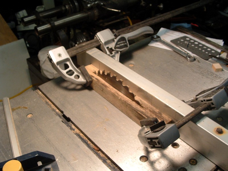

Sooo, to provide proof of concept I spent about fifteen minutes in the shop with some scrap wood.
Ripped the wood square, clamped it to the tablesaw fence and raised the blade (10") as far as it could go.
holder on saw.JPG (106.18 KiB) Viewed 2629 times

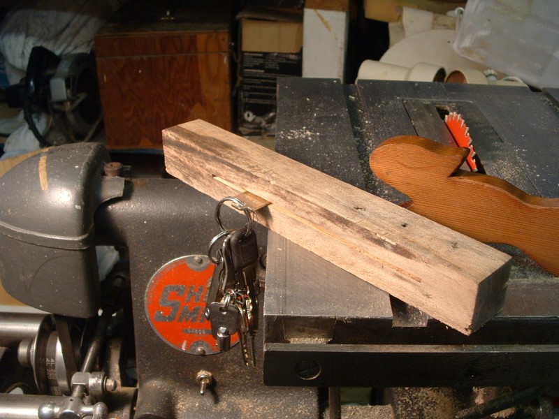

The wood is about 1 1/2" square, the slot produce is about 7 1/8" at the front and about 9" at the back and the keys fit in the slot.
and here it is with keys.
holder with keys.JPG (124.15 KiB) Viewed 2629 times
I think we have a winner. :D

Why is a 10E? in the last pix? :D
I am used to the tree rat!
Re: New Project, questions, long intro
Posted: Wed Jan 21, 2015 2:45 pm
by rpd
JPG wrote:Why is a 10E? in the last pix? :D
That 10ER is my main machine and was a convenient place rest the holder so the keys could hang down.
Also it provided ShopSmith content :cool: .
I did try to cut the slot on the 10ER first, but with the 8" blade I didn't get enough blade exposure so I used my cheap table saw instead.
My other 10ER is set up as a dedicated drill press, and my Mk5 got stalled in restoration and is still awaiting reassembly :o .
